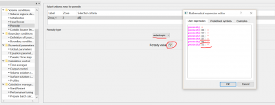

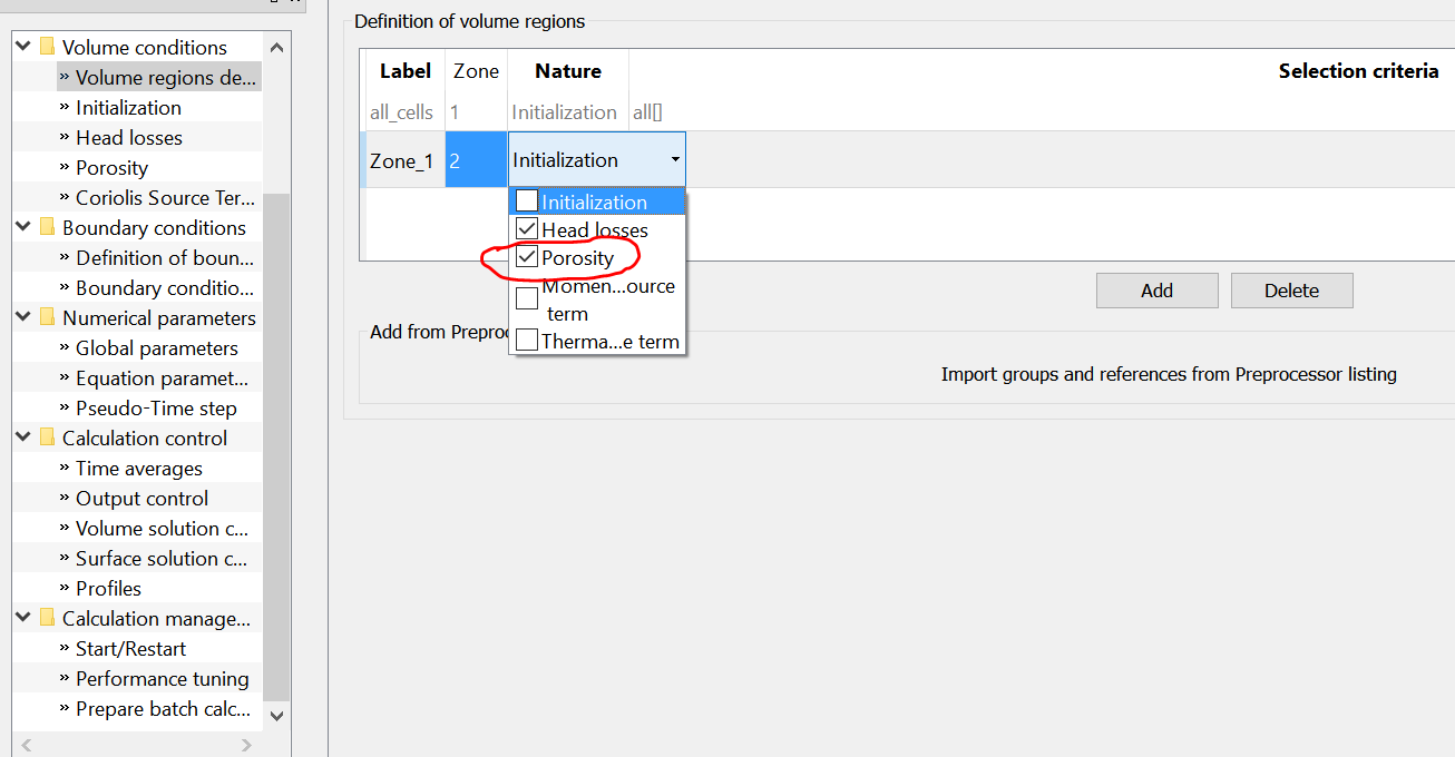

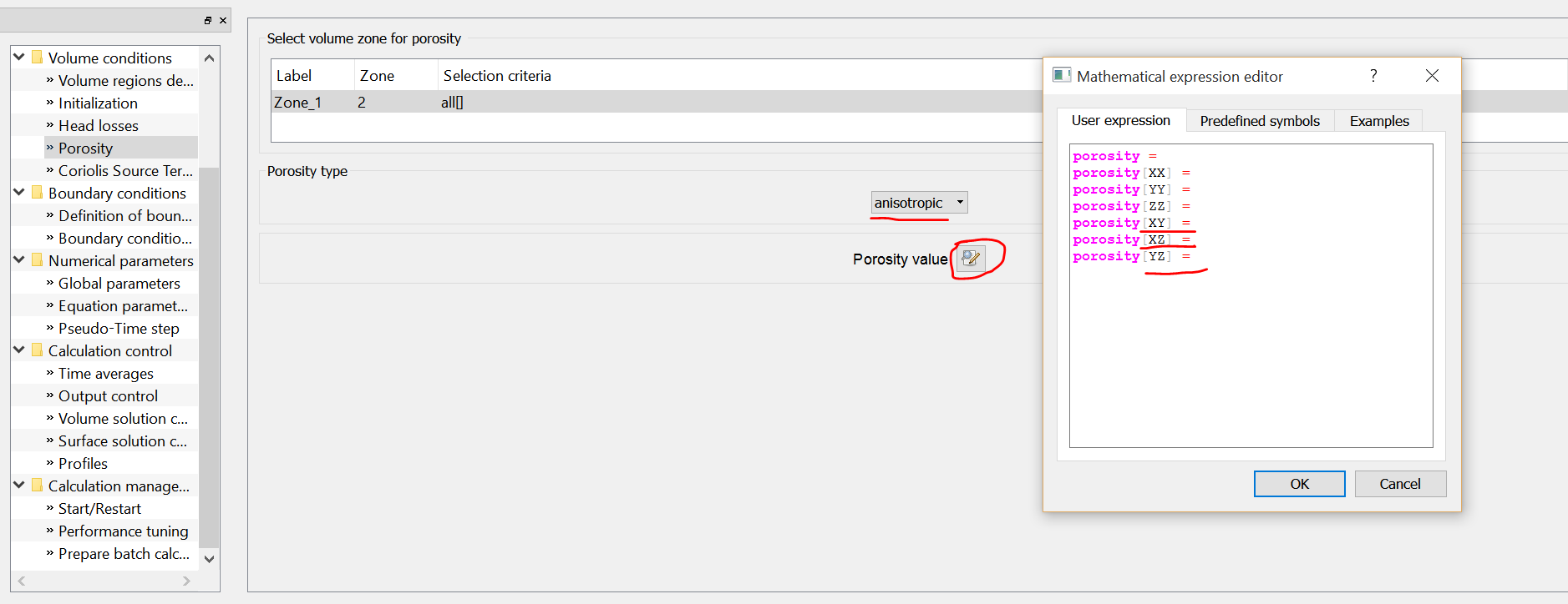

But actually while initializing a volume and choosing porosity. A new field appears where I can adjust the porosity. see attached pictures. Are those functional, it seems there are results coming out from them .
Choice between isentropic and anistropic are available, when using anistropic. there are additional parameters. I am assuming porosity xx is in the x direction, but how about Porosity xy specifically, what does it mean?

The documentation might not be completely up to date in this regard.
For anisotropic porosity, the xy term is one of the terms which appears when the porosity tensor is not alligned with the axes and you apply a rotation to describe it in the reference coordinates.

So just to confirm I want to make a medium porous in only z direction as 50% porous.
porosity=1.0; (I am not sure what to set this up as)
porosity[XX]=1.;
porosity[YY]=1.;
porosity[ZZ]=0.5;
porosity[XY]=0.; (not sure what values to put here)
porosity[XZ]=0.;
porosity[YZ]=0.;

I have been trying all kinds of combinations with this but it is not working, what should I do to set up the porosity to be in a certain direction, say x axis for example?
- Posts: 4283
Re: Porosity setting in GUI 4.0
I'm not sure about this part, and documentation is "weak" on this aspect...
You may try using 1's instead of 0's for the other directions, but grepping the code, is is also important to set iporos to 2 instead of 1 in cs_user_parameters.f90 (search for iporos in the file, set test to true or remove test).
