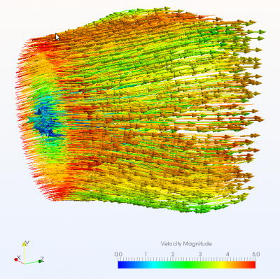

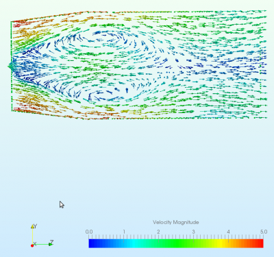

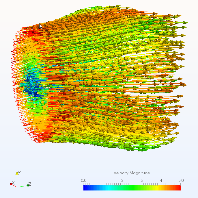

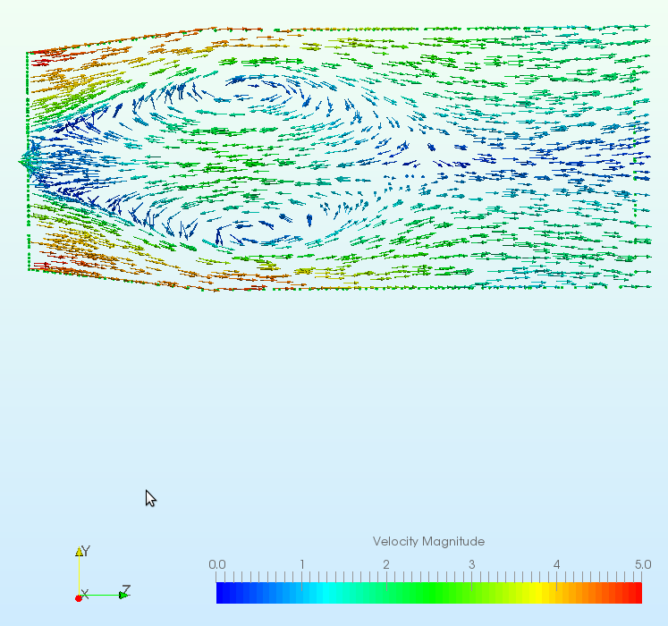

Fortunately, I have debugged my "swirling" inlet functions and now they seem to work OK (attached two pictures for example). Maximum axial velocity is 5 m/s (peripheral), it lowers and becomes negative at the center (test case, profile resambling gas turbine outlet). Tangential velocity is relatively small (less than 0.7 m/s).
