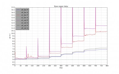

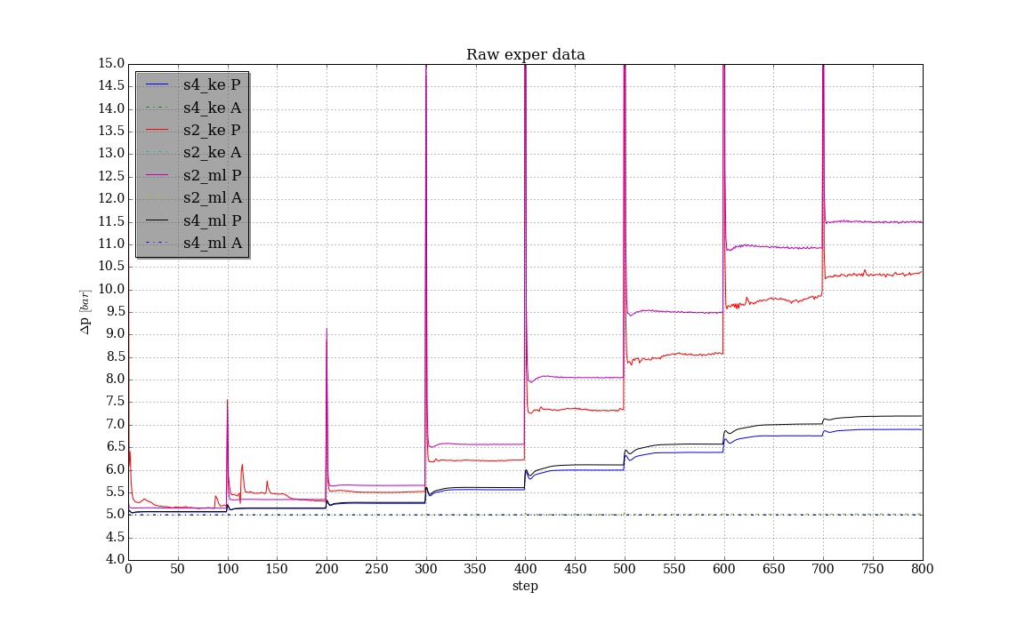

I've attached:
- a graph plotting the pressure read at inlet (P port) and outlet (A port, fixed @5bar). Raw data are in Pascal, but have been scaled in the graph to bar

Comparison of Saturne 2 and Saturne 4 results

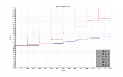

I've finished the simulation with k-eps and sat2.
I attach listing and comparison of the results.
Claudio
Claudio
