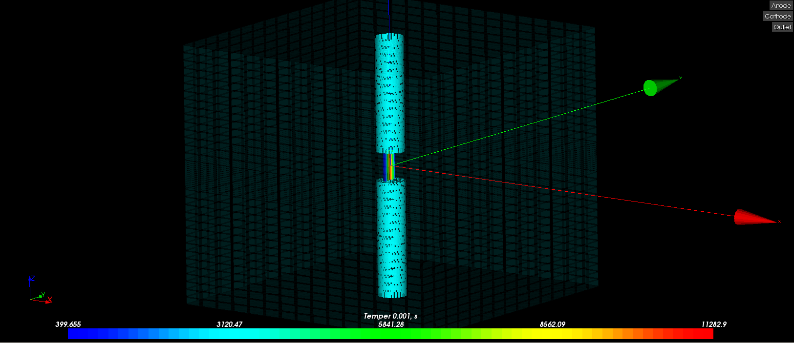

I would like to know if I want to model the DC electrical arc between two vertical electrodes in Code Saturne 3.0.0, do I need to consider the subroutine uselrc.f90? Please refer to the picture to see the detail about my model.
When I try to use uselrc.f90 subroutine in my model, I always got the error "error (divergence) solving for Enthalpy", so I think probability I did something wrong in this subroutine.
The only I changed in uselrc.f90 is the current and the calculation of the intensity of the arc current. I changed this based on my geometry, I set these two parts as below:
