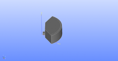

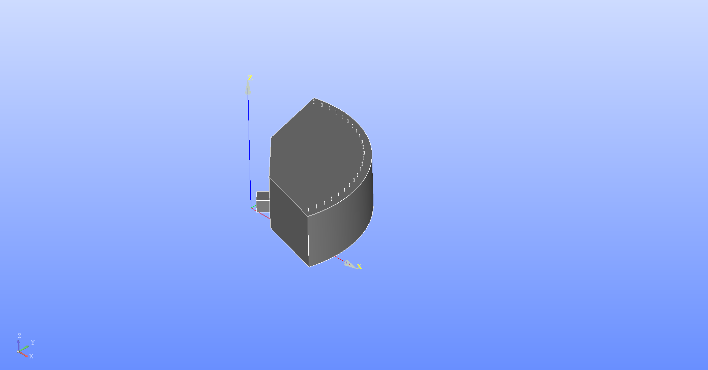

I have attached a picture of the model (24 jet diffusers on top, curved glazing wall, exhaust on the back of the room).
1. Do I really have to extrude a solid volume from each boundary surface? If yes, would a thin wrap around the fluid model (2/3 cells and maybe 10cm thick) be sufficient? I have no particular interest in studying conduction effect in the building structure.

Re: radiative boundary condition through glass window
Here is a short answer :
1) The solution you suggest seems OK. Assuming the building materials have pretty low conductivity, and heat is transferred mainly through convection with the fluid, this seems reasonable (even with only a few cells, you can do 2 runs with significantly different conductivities and/or specific heat values in the solid to check there is not a big sensitivity to this aspect).
2) You are correct.
3) I'm not sure if Syrthes has a specific way of handling the greenhouse effect (and the Syrthes developers are out of office this week, so I can't ask). If not, I would assume the lower the specific heat you assign to the glass, the less heat can be absorbed through it, so this might approximate (in a crude manner) the greenhouse effect. Just a quick idea, so I'll let you check if this seems correct physical modeling to you.
