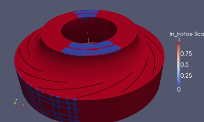

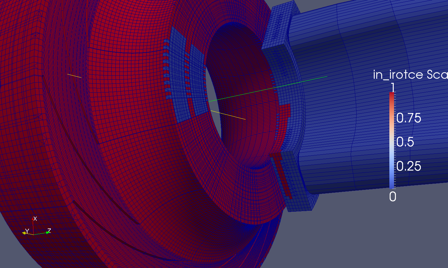

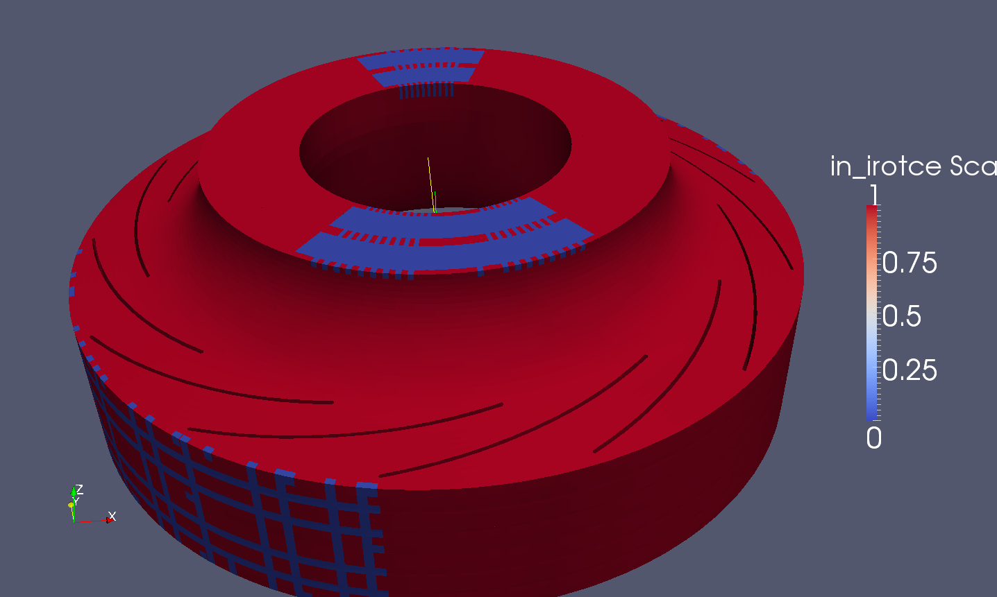

I just wanted to understand some parts in the code related to coriolis force source term so i created an additional postprocessing output which sets all elements with (irotce.ne.0) to 1 and everything else to 0 (I therefore use cs_user_postprocess_var and loop through all cells and check the irotce flag). The field irotce is from base/turbomachinery.f90. The results can be seen in the appended pictures.I use code_saturne 3.3.0.

Otherwise, your postprocessing problem is probably due to an error in your user subroutine. When you call post_write_var in cs_user_postprocess_var.f90, do you set ivarpr to 1 or 0 ? Depending on how you looped on cells (using lstcel(iloc) or directly), you must use one or the other.

That is the best what could be, just a fault of mine! I already investigated quite much, but if one wants to add some extra source terms, it is a lot to learn about the code. But as you pointed out cjanging ivarpr to true did the trick.

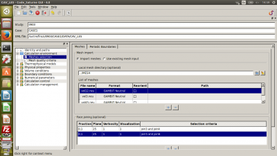

I'm new in Code_Saturne (V. 4.0.4) and I work on GUI. I use a standard venturi such as geometry.
Cause of memory limitation, I had to subdivide my geometry. So now I have 3 Meshes and I want to join them. I uploaded the files on meshes selection and I also added 2 face joining (for 4 face).

The meshes section screen and check_mesh.log are attached.

You have no joining, I believe because yoour selection criterion is incorrect:
"join5 and join 6" means you select faces that belong both to groups "join5" and "join6" (logical "and").
To select faces that belong either to "join5" or "join6" (logical "or"), use "join5 or join6".
