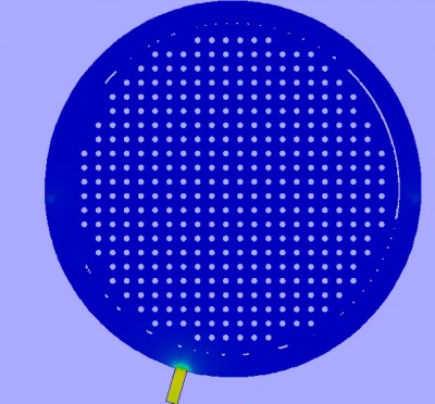

Yvan I have another problem. I have merged two meshed parts along a curved surface. I have attaced a pic of my early results. As you see, there are some blank spots at the postprocessing stage. It is strange beacause in other planes at the same area they do not exist. Any idea what is the problem? is it a postprocessing bug or a merging problem?

This is probably a merging problem. You can open the JOINING.case to see the "joined faces".

In fact when i import it in tecplot, these blank spots disappear! It really seems that there is a problem related to Paraview. I've checked joining.case it has been correctly selected.

ParaView still seems to have some bugs displaying general polyhedra (which are produced by Code_Saturne's mesh joining when faces are initially non-conforming), but joining in curved sections can be tricky (the theory documentation goes into more details about this, and the best practice guidelines on this website should provide recommendations),
In any case, visualizing the joining (and possible the boundary mesh), checking everything is joined correctly is always recommended, but some checking methods are more "robust" than others. As such, checking the joined faces parts or the boundary parts only require handling polygons, whose display is usually less buggy. Another solution I am not too fond of is to activate splitting of polygons and/or polyhedra in the writer options. I would love getting rid of that option and the corresponding code, but that would require that most visualization tools coold handle polygons and polyhedra well enough, which is unfortunately not yet the case...
