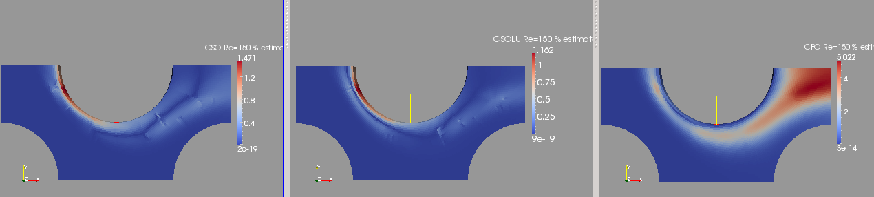

Hi, thanks for the suggestion. The slope test was actually active, although I had originally intended for it not to be. However, deactivating it did not affect the feature I am trying to remove. The first row of cells along the constant value boundary are still much larger than expected.
I have attached a picture to show the problem. What's shown is for the flow around a cylinder at a constant temperature. I have solved to find the temperature, as well as solved an additional equation to find the temperature squared. The pictures show the absolute values of the difference between the temperature solution squared and the temperature squared solution. From left to right is for the second ordered centred, then SOLU, then first order upwind.
Along the boundary these distributions should be going to zero since the two solutions are defined here.
