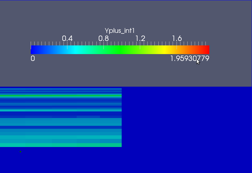

I use code_saturne.2.0.2 and I run simulation with K-Omega SST model.
I try to post-treat the Yplus values using usvpst.f90 routine.
if (ipart .eq. -1) then
  iphas = 1
    ! Initialize variable name
    do ii = 1, 32
      namevr(ii:ii) = ' '
    enddo
    ! Variable name
    namevr = 'Yplus_int1'
      idimt = 1
      ientla = 0
      ivarpr = 0
      do iloc = 1, ncelps
         iel = lstcel(iloc)
         tracel(iloc) = ra(iyppar+iel-1)
      enddo
      call psteva(ipart, namevr, idimt, ientla, ivarpr,          &
                  ntcabs, ttcabs, tracel, rvoid, rvoid)
endif
The problem is that the Yplus values are clipped (by zero) and also there is a discontinuity of these values (see attached file).
1- Does any one know why Yplus values in the main volume mesh are clipped by zero ?
2- And why is there this discontinuity ?
Thanks in advance.
Regards.
RC

Regarding (2), you should check the usage of ivarpr, as explained in the usvpst.f90 user example.

it seems that code_saturne doesn't calculate "yplus" values inside the main mesh when using RANS models, it does that only in the boundary faces. Hence, the array "ra(iyppar+iel-1)" is empty.
Could you please confirm this ?! and if possible, suggest a solution to post-process the yplus values inside the domaine and at the probes when using RANS models?!

I tried with "ineedy=1" but it doesn't work (ra(iyppar) is not updated). I'm not sure but I think that ineedy is used to force the distance to the wall and not the Y+.
I have an idea to post-process Y+ inside the domain but I need your opinion :
1- From "clptur", for each boundary face "iface" I save the corresponding "uet" and I look for the nearest cells to the normal of this face in main mesh.
2- I calculated then Yplus(iel) = uet * y(iel) / nu(iel).
Question : is there a solution in code_saturne to look for the nearest cells to the normal defined by (rnx,rny,rnz) ?!
Thank in advance

You must use distpr and distyp subroutines to compute y+ in the fluid domain. Set ineedy = 1 to get y(iel) and use distyp to get y+.

Ok, your solution works but I must force "clptur.f90" to update "uetbor(ifac,iphas)" even if the LES models are not used (itytur(iphas) not equal to 4).
So, the problem is solved by setting "ineedy=1" , using "distyp.f90" and comment the following line in "clptur.f90" to update "uetbor(ifac,iphas)" :
 !if(itytur(iphas).eq.4.and.idries(iphas).eq.1) then
      uetbor(ifac,iphas) = uet
      if (visvdr(iel,iphas).lt.-900.d0) then
        propce(iel,ipcvst) = propce(iel,ipcvst)                   &
             *(1.d0-exp(-yplus/cdries(iphas)))**2
        visvdr(iel,iphas) = propce(iel,ipcvst)
        visctc = propce(iel,ipcvst)
      endif
  !endif
Thanks for help.
Regards
