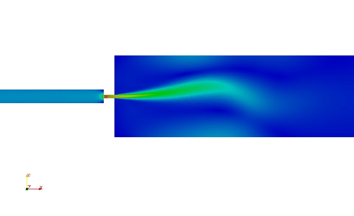

My case study is an incompressible jet with DeltaP=8 bars. I attached the contour of velocity. Restarting the calculation by these values, the simulation diverged. SIMPLE algorithme with k-e standard. I tried to change the relaxation factors but it did not work.
