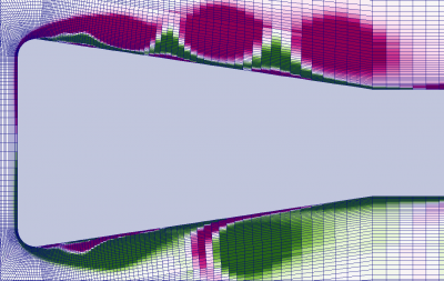

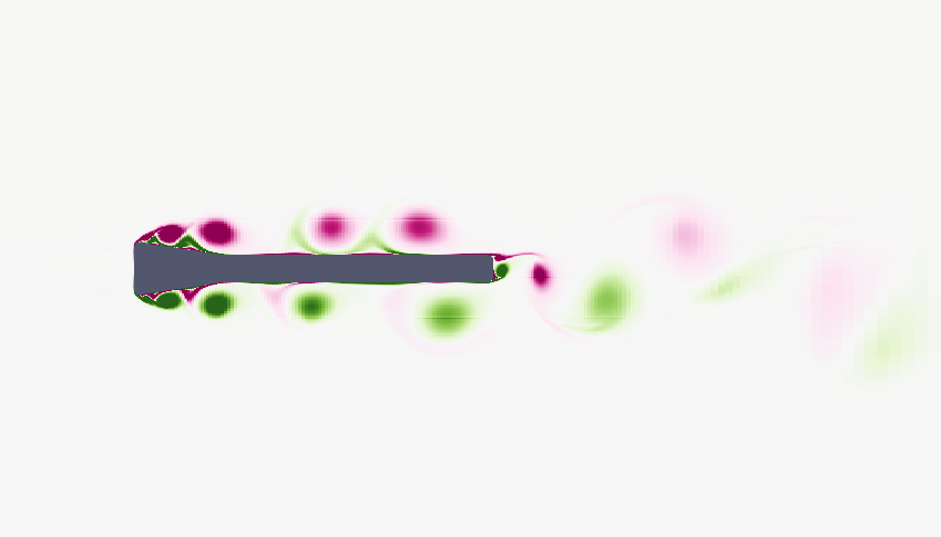

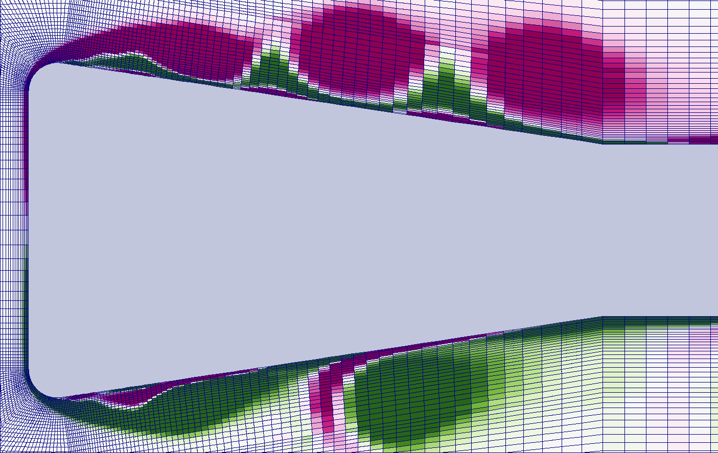

I am currently studying the flow-induced vibrations of hydro power plant trashracks. One part of that study is a numerical investigation, modelling the problem in 2D. I already got some results for the flow pattern around a trashrack bar, using Code_Saturne at a Reynolds number of about 5000 with the turbulence model "Rij-EBRSM". This is how the vorticity looks like :

I assume their must be some problem with the deformation of my mesh, but I couldn't find which cell gets broken, so I haven't fixed the problem yet. I have tried to abide by the best practices for mesh generation, i. e. having rectangles in the mesh, but this proved to make the meshing process (using Salome) quite tedious.
Would you advise, in that case, that I preferably use a mesh with triangles? I guess it would make the task of refining the mesh close to the wall easier.

Switching to tetrahedra will not help, and probably degrade your results quality (assuming an equivalent number of cells).
As ALE deforms the mesh, some cells may become inverted, and that seems to be the case here.
The usual solutions to this are to reduce your time step and/or increase "mesh viscosity" (the latter so that deformations are spread over a wider number of cells, so as to avoid having large deformations only on cells near the boundary).
The more refined the mesh near the wall, the smaller the deformation required to "invert" a cell, so using a slightly coarser mesh may help (I do not believe ALE is often used in conjunction with low-Reynolds models, requiring a refined mesh at the boundary, so its robustness in these cases may not be very well tested).
As you seem to have run tests with mesh viscosity, if this is not enough, maybe using a smaller time step may help.
