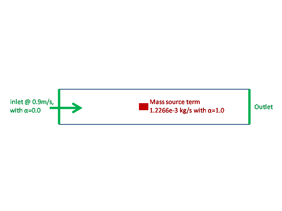

Let me explain my case again, I've joined a scheme. My domain is filled with gas 1 at t=0, with an inlet at the beginning of duct supplying it with gas 1 () at a velocity of 0.9m/s. In the middle of my duct I've put a source of gas 2 () which might provide a mass flow of 1.2266d-3 kg/s of gas 2 (and 0kg/s of gas 1).
My domain is long enough to ensure that no gas 2 left it during the unsteady simulation.

Your result is not surprising because in ustsma you are injecting gaz mixture with in other words at the beginning of the computation you are mainly injecting gas 1 (and not 2) and you do no retrieve your 1.22e-3 kg/s of gas 2 but 1.22e-3 kg/S of (gas 1 - gas 2).

You can't control the injection of gas 1 or 2 it's alway a mixture.
If you want to create a classic inlet in your domain you can use the thin walls (cs_user_mesh.c) to transform a n internal face into boundary face.
