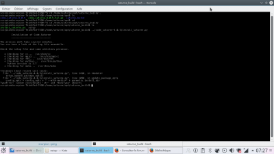

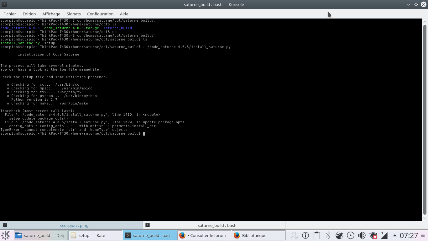

Hello. I would like to install 4.0.5 - Code_Saturne , but I can not. I installed all the necessary library via synaptic and when I launch the automatic installation , I get errors . Here attached the file " Setup1 " generate the file "setup" to change the installation and the image of my terminal.
Please , help me
Cordially!

We need to check, but your error message seems to be due an issue with the "auto" setting for METIS, so I recommend either using the installer to install METIS, or not use METIS at all (i.e. use any settign other than "auto").
