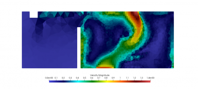

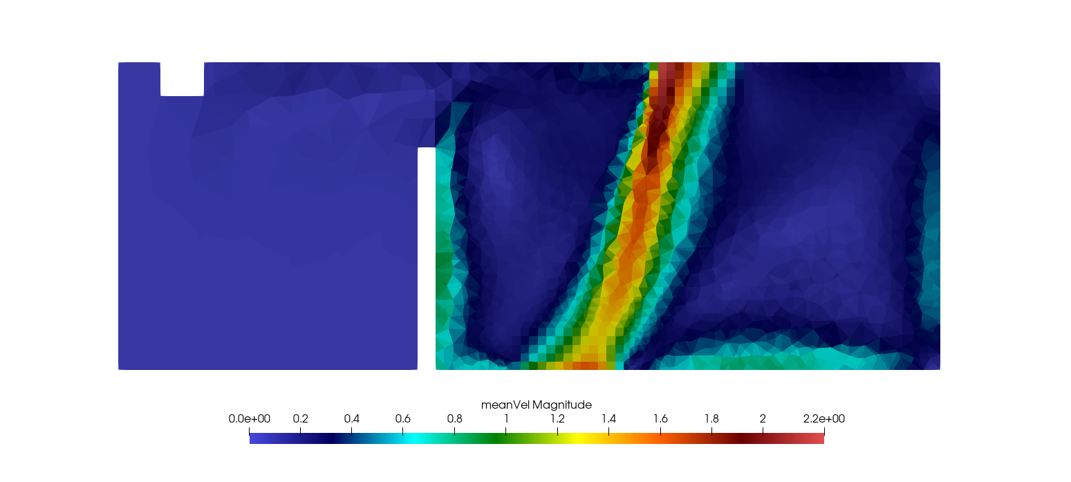

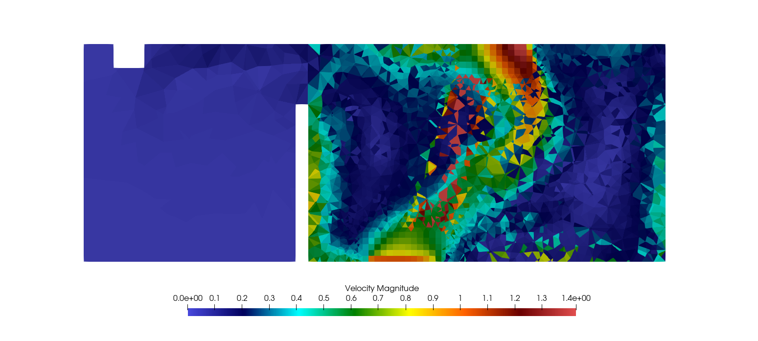

However, in visualization by Paraview, something strange happend.
When I checked the instantaneous velocity field (this is should be "meanVel" field of the previsou computation), the field seems to a field mixed with instantanesou and mean velocity filed. You can see this in following pictures. First and second pictures are instantanesou and mean velocity field at last time step in the previous computation. Third picture is a "instantaneous" field which should be meanVel field.
For some meshs, meanVel field is taken into account, but instantanesou field also can be seen.
Are there some mistakes?

If you are running in parallel, just as a precaution, you can replace "n_cells" with 'n_cells_with_ghosts' in the loop where you copy mean to instantaneous velocity. just to make sure ghost cells are handled immediately an side effects are avoided.
If this is not enough, could you post the run_solver.log file for 10 or 20 restarted iterations ?
Also, the instant/mean mass flux may have an impact. So first, can you do the same operation (copy) of mean to instantaneous values for the mass fluxes ?

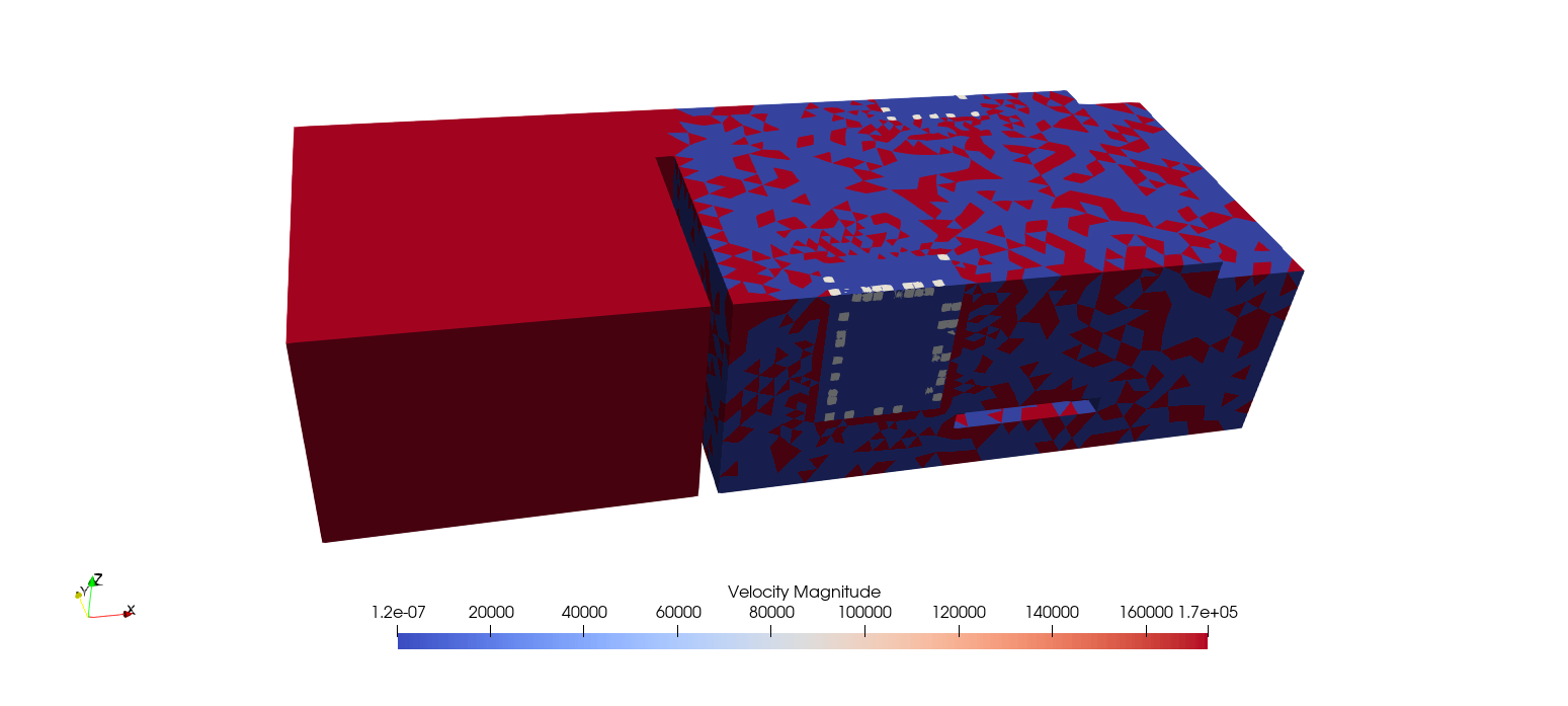

Whwn I use the following code to check where the code works or not, it seems that part of instantaneous velocity field was replaced with new value (in this case:1e5). You can see the result in picture. Blue zone cannot be replaced by mean velocity.
In my case, computation was done with 4 parallelization. I checked how it works without parallelization, and same problem happend. So problem is not due to parallelization.

I downloaded the files, and did not run the case yet, but looking at them, I probably have a simple explanation:
Since velocity is a vector field, you need to copy 3 values per cell, no just one. So you are only copying the first 1/3 of values.
The following version should work better:
