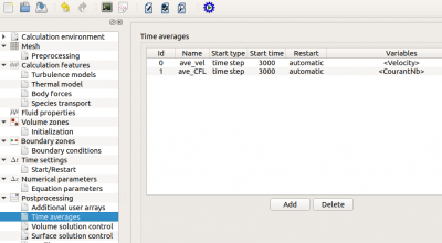

As you said, I edit the SRC file like this:
However, the scalar is calculated based on the velocity field of last time step, not average velocity field. Scalar seems to be convected (but this result is based on the velocity field of last time step).
Would you give me some tips?

Re: How to calculate scalar based on frozen average velocity?
Is it correct to put a name "ave_vel" written in a picture into ""cs_field_set_key_str(vel, kr, "velocity_mean")""? Best regards,
Hamada
Hamada
- Posts: 4303
Yes, if you named the field ave_velocity, you should use that instead of velocity_mean.

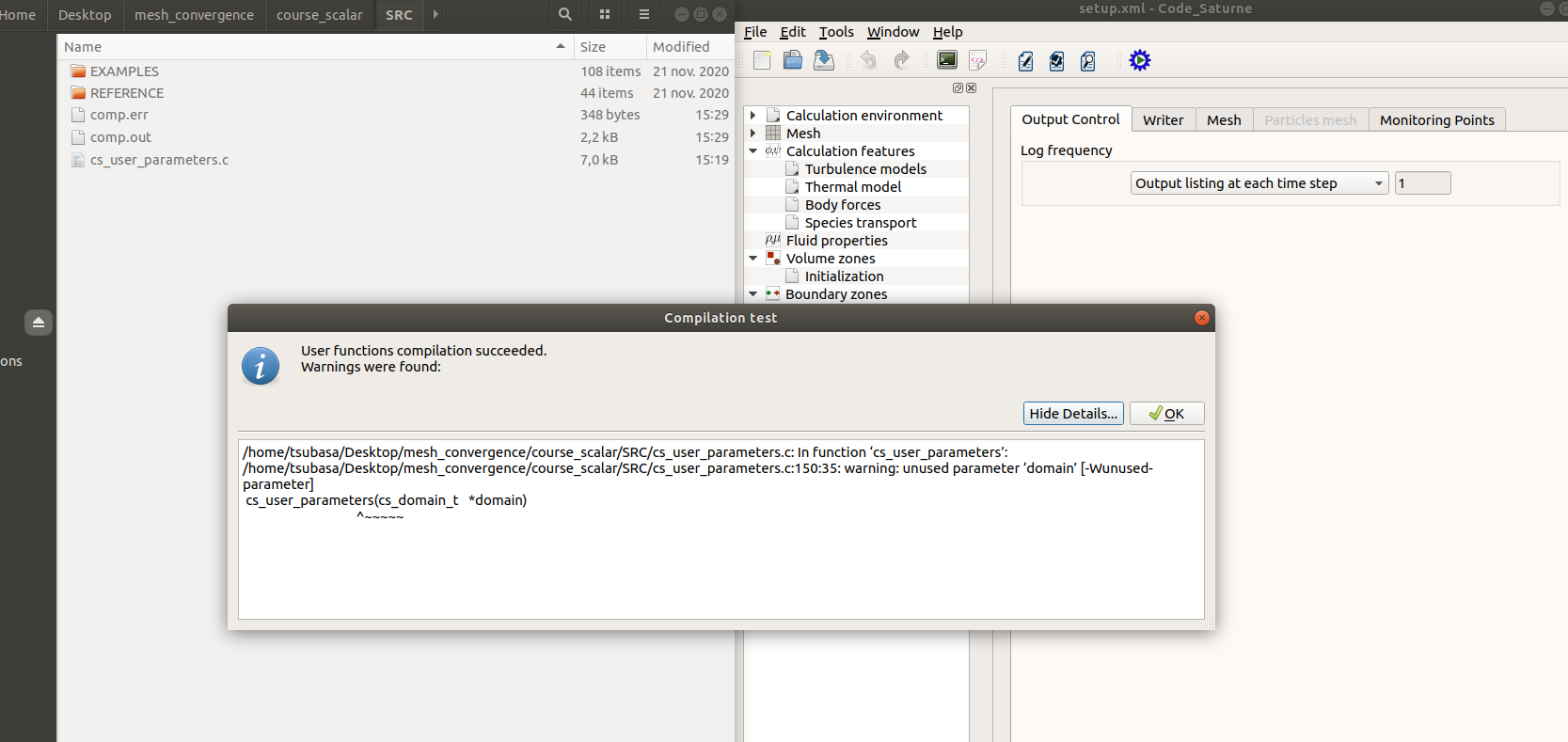

To check the script, can I tried "test the compilation of user function inside the SRC folder" in GUI?
When I did it, I always have this kind of message but this message can be seen when I used another script, which can be used correctly.
"test the compilation of user function inside the SRC folder" in GUI is not so important?
Hamada

- Posts: 4303
This is just a warning about an unused parameter, so not a problem.
