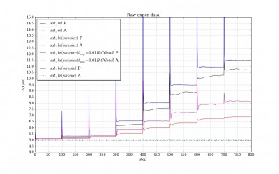

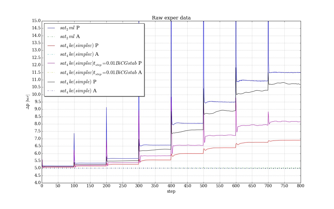

I've completed a simulation with:
- SIMPLEC algorithm
- reference time step 0.01 (1/10 than before)
- BiCGstab with 1e-5 precision
It took almost 19 hours over the weekend.
Courant number is now <20 almost everywhere and regions >1 are small.
"c Velocity" is about 60-70 at each step.
The overall pressure drop is in the attached file.

- SIMPLEC algorithm

With all the previous tests, I have lost track of some details, so it would be interesting to also post some info about your latest data setups (listing, setup.log, performance.log files), to see if I have any additional recommendations.
The "final" pressure drop is difficult to interpret without details in those files.
Also, in addition to the pressure drop plot you have, a cut plane visualization of pressure and velocity on different options may be interesting (even if you don't post them, checking them to see how the flow differs in a more qualitative manner may be useful for you).

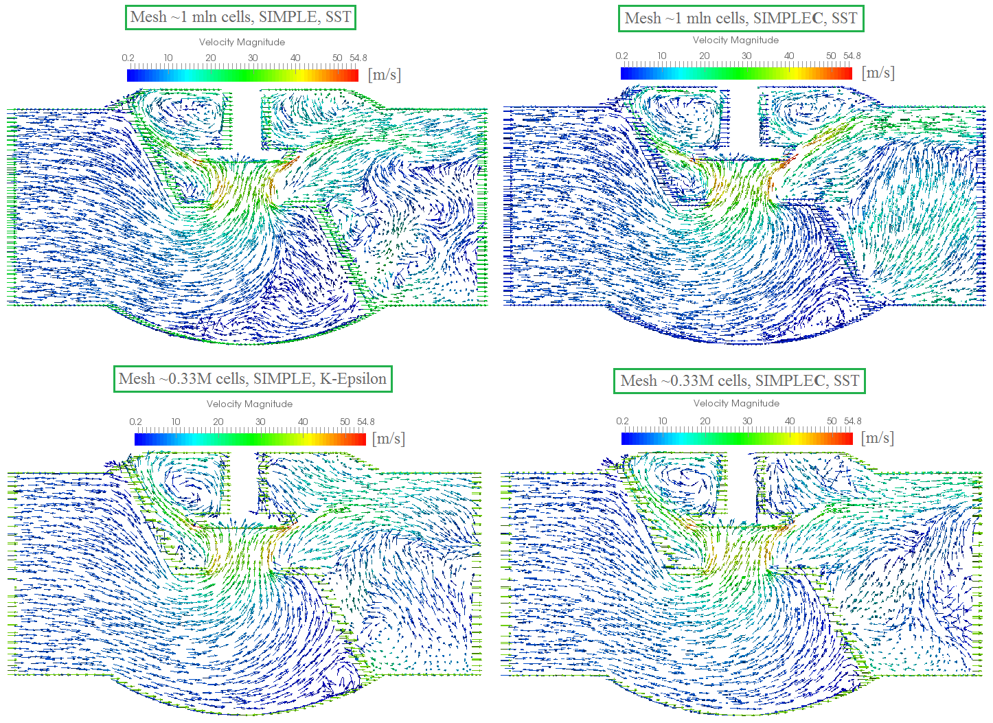

Ccaccia73

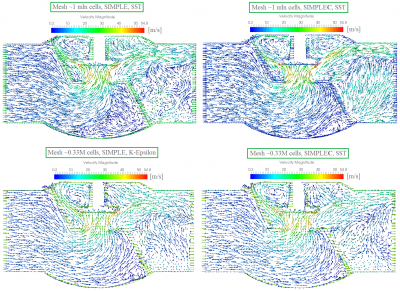

Results look a bit terrible taking into account that CFL<20. Not a disaster, but so big difference (~8.25/~11.0 bar) in SIMPLE/SIMPLEC results is not pleasant.
I performed my test calculations with abstract valve geometry. Results are more or less normal except maximal velocities (not pressure difference) with Reynolds stress model.
I attached the 3D geometry outline in my previous post. Valve consist of inlet part, membrane with orifice, disk on a stem and outlet part (sorry for terminology, I don't work with valves). Inlet and outlet diameters are 100 mm, membrane orifice diameter is 40 mm. Tetrahedral mesh built with NetGen in Salome (two variants with ~0.33 and ~1.0 millions of cells).
Fuild is water with density of 1000 kg/m3 and dynamic molecular viscosity of 0.0002 Pa*s. Inlet velocity set to 5 m/s, walls are smooth.
There was five main variants:
1. Mesh ~1 mln cells, SIMPLE, SST turbulence.
2. Mesh ~1 mln cells, SIMPLEC, SST turbulence.
3. Mesh ~0.33 mln cells, SIMPLEC, SST turbulence.
4. Mesh ~0.33 mln cells, SIMPLE, K-Epsilon turbulence.
5. Mesh ~0.33 mln cells, SIMPLE, RSM turbulence (second and third RSMs from 4.0.0 GUI).
Number of iterations in all variants was enough (IMHO). I controlled the solution by maximal pressure stabilisation (in fact - our target parameter, pressure drop) and maximal velocity stabilisation. Minimum number of iterations was more than 300 (AFAIK), for first variant ~700 iterations, for second (based on first) ~700+500 iterations.
I attached the archive with my case (without big RESU directory), it's abstract and not confidential.

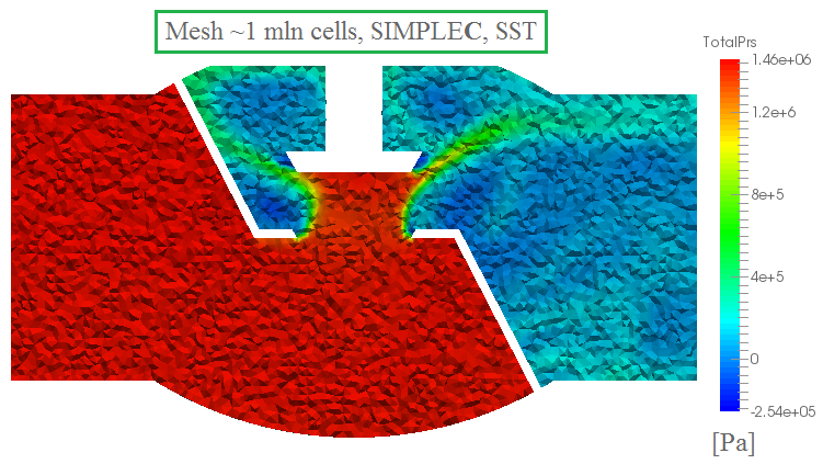

You can see the comparison of velocity fields in axial cross-section on attached image. Primary flow features and velocity levels are very similar with different meshes and turbulence models (SST/k-epsilon). But there are differences in secondary features like recirculation zones or "slack flow" zones. It's not very good, but also is not surprising, you may obtain differences like these in commercial programs too (various programs or turbulence models). We should also take into account that flow may be unstable in "secondary" zones.
RSM variants on "0.33M" mesh didn't converge, there was maximal velocity spikes up to thousands m/s while normal level is 71 m/s (it's not in the axial section on the picture or there are interpolation issues).
Meanwhile, pressure difference on this abstract valve was almost the same in all variants and lied in range 1.41...1.45 MPa depending on variant and iteration (even including one non-stable RSM variant). As you can see from total pressure distribution on the picture below, pressure loss in this case, like in many other cases, is due to local accelerating of the fluid (dynamic pressure increase) with subsequent slowing down and dissipation of energy that was associated with dynamic pressure. Please note that total pressure on the picture (and, IMHO, in most other meanings) is a sum of static and dynamic (0.5*rho*w^2) pressures, not an absolute pressure like in Saturne terminology. Distributions of total pressure are very similar among tested variants so I only attached one of them.
So what do we have? There are apparently no significant difference between my valve-test variants (in pressure drop) inspite of changing the mesh and turbulence models. Therefore, I don't see the way I can help you because your geometry is confidential at the moment (it's OK, I just point it). Possibly we'll found the reason for different results when you will get the permission to upload you geometry. Have you performed current test with the old mesh or with refined mesh?

The differences in results are probably related to a time step issue, and the initial time step may have a role.
Also, the major point (why I recommended looking at the velocity and pressure fields in detail in the first place) is that if there is no significant influence of the turbulence model (or code version) on the velocity and pressure fields, there should not be a major influence on the pressure drop either. Meaning the difference may be "artificial", due to the way things are postprocessed (as measuring a pressure drop in a 3D complex geometry is often more tricky than it seems).
I doubt there is a bug with intermediate outputs, as I use this feature quite frequently (so I should have noticed). The "binary"/"empty" aspect is not an issue, as binary is the default.
Are you sure you associated the additional writer to your output meshes ? Did you check the "auto" variables feature for possible additional meshes ? They don't seem to be in your xml files.
I am interested in details about the crash when you stop the calculation from the GUI. Partitioning info is not written by default if you use space-filling curve (Morton or Hilbert) partitioning, as it is deterministic an can be recomputed easily. Otherwise, you can change this behavior in the "performance tuning" section fo the GUI.
For the cases that don't converge, a "listing" (and "performance.log") file would help me guess whether the issue is due to a too high initial time step (even if the later target is good), to a mesh quality issue, and how best to work around it, without needing to run the computation.

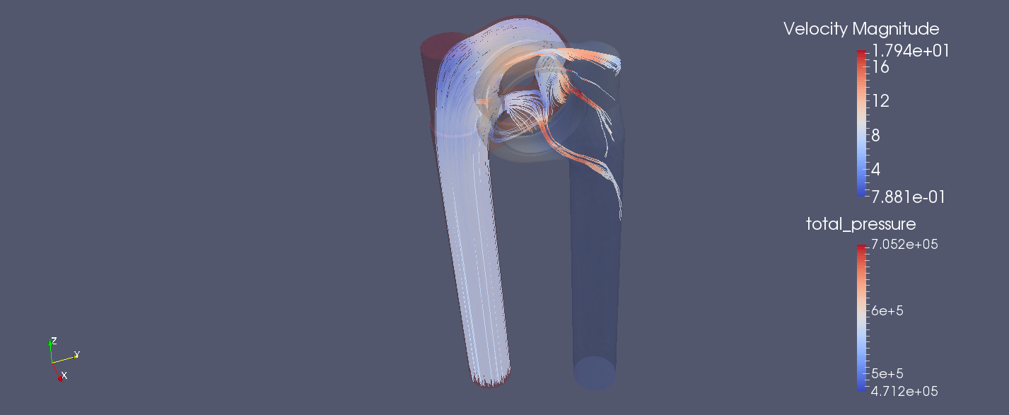

Now about the diverging RSM case. I performed another test yesterday. Model was set to Rij-SSG, reference time step 1e-05 s, target CFL=1.0. Despite of a very small time step, velocities was up to 10^5 m/s
Is is laminarization, or it's not actual for SSG? I attached a case archive without large files in RESU. If you want, I'll upload whole RESU directory. Relevant settings are in "Valve Mesh=1M RSM" XML, you can open the case directly in GUI.

Sorry for the usual lag, I just collected the data of the last 3 tests:
test01:
- simplec and improved pressure interpolation
test02:
- simple
test03:
- simplec, tstep = 0.01 (1/10 wrt. previous tests) and biCGstab

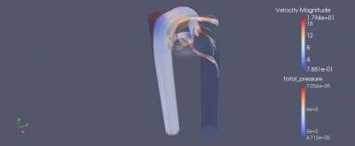

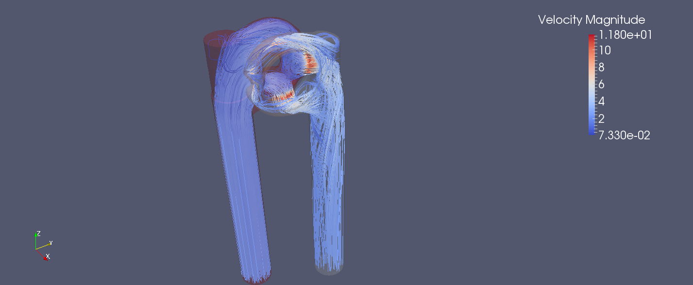

when trying to plot streamlines with Salome/ParaVIS, it looks like there's something not working properly. This is what I have when I plot streamlines from Saturne 4 results: And this is what I have form Saturne 2 results (please note that they're not exactly the same conditions, so absolute values might be different)
