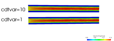

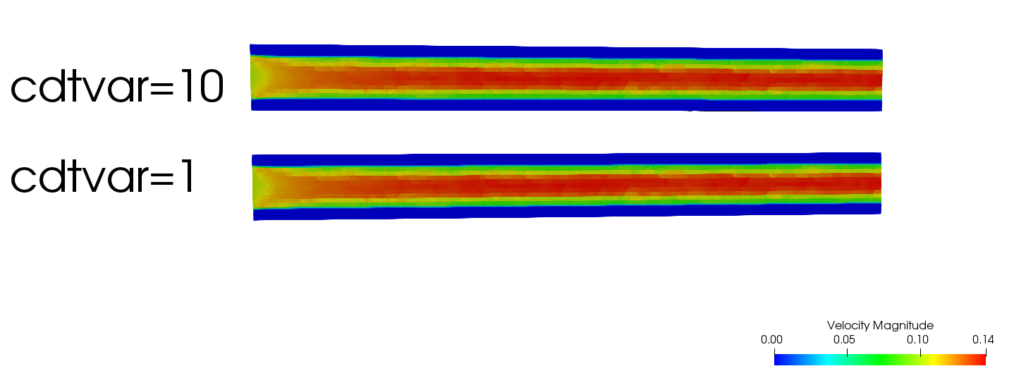

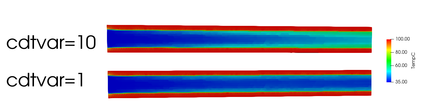

As Yvan mentioned, you can change the time step factor (cdtvar) for the temperature to have similar characteristics times to reach a steady solution in case it exists.
In the following figure, you can see the difference in the temperature field for the same simulation time, while the velocity is the same.
