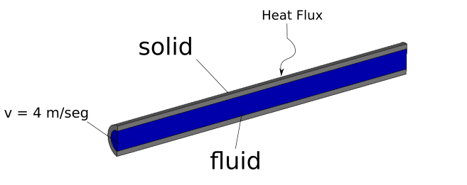

Hello I am trying to run a case of a tube that receives a flow of heat and is cooled by a fluid (a heat exchanger). I attach an image of the case I want to simulate. Reading the user guide (version 7.1), I understand that it can be done in code_saturne with the Internal Fluid-Thermal coupling option. I have followed the steps of the guide but it is not clear to me how to configure the mesh and the border conditions of my model.
I attach the model to see if you can contribute or give me advice

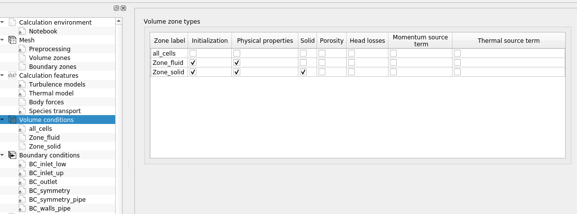

In the code_saturne GUI; you need to define a volume zone based on the "Solid" group selection criterion (based on the groups present in your mesh), and in the "Volume zones" section check the "solid" box for the zone. The internal coupling feature should then be available.

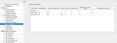

I am trying to simulate something similar, but I cannot prescribe physical properties for the fluid domain.
Also, there is no option for solid-fluid interface.

This may be a minor bug. What is usually done is to define the fluid physical properties for the default "all cells" volume zone, and the solid physical properties for the solid zone. In this case, you can "uncheck" the "physical properties" box for the fluid zone, and check the one for "all cells".
Let's see if that works.

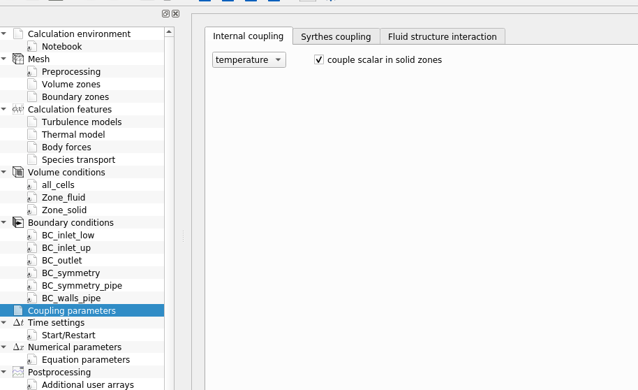

You need to visit the "Coupling Parameters" page, "Internal Coupling" tab, and check "couple scalar in solid zones" for the temperature.
The rest is automatic: the mesh is subdivided automatically along the fluid-solid boundary, and default wall laws are applied.
Default boundary groups are also created ("auto:internal_coupling_0_fluid" and "auto:internal_coupling_0_solid" if I remember correctly, but you can check in the run_solver.log after a first test.) Using those, if necessary, you can define mesh boundary zones to apply additional settings. This is useful for example to indicate surface properties for radiation.
But in the common/simple case, you do not need this.

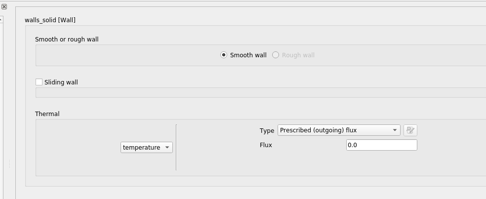

- you have nor "rough wall" option because this is related to turbulence modelling, and you are not using a turbulence model.

Well I checked couple scalar in solid zones, but until I used joining faces in mesh tab, there was no heat transfer.
But I have no option rough wall even if I tick turbulence.
