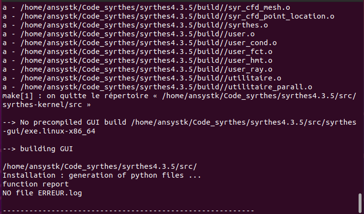

Ideally I would like to install the 5.0 version. Nevertheless, I try to compile the syrthes 4.3.5 version with your python file, there is some progress but the installation fails now when building the GUI. In the log, there are some message from the mkdir command: "mkdir: operande manquant"

Re: Syrthes 5.0 / CS7.0 installation
I checked the log files. I could not find the error. I have attached the log files. As previously said, the install script seems to fail at the GUI building. I tried to build independently the GUI by following the specific procedure but it fails also after 3H at the moment of the QT building.
