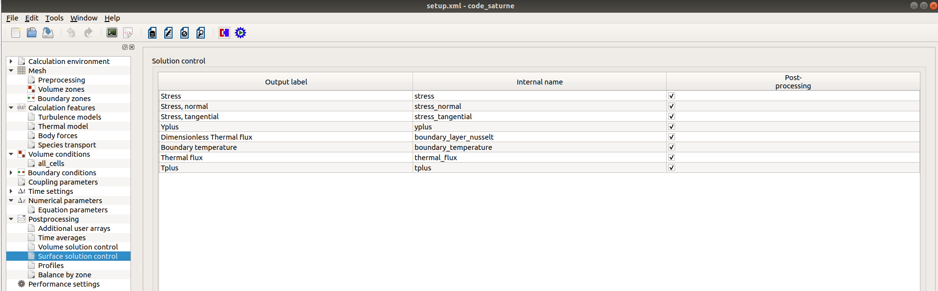

Thanks for your reply. I double-checked, when I ran the case, I activated the stress options in the GUI, as shown in the figure below.
Also, I confirmed from other cases (which I can run smoothly), that when I ticked the stress boxes in the GUI, I can have the instantaneous shear stress values in the results. So I suppose the error isn't come from here?
