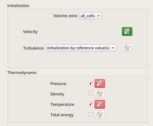

Hello again,
Is it possible that during the initialization the thermodynamic variables are not initialized correctly? I have attached a picture. Every time I set a value for pressure and temperature the icon turns green and in the context menu it shows the correct value. However, if I switch to another menu and then back, the icon is red again and die context menu says "Initialize the temperature in K. Tick the check box and ...". Does this cause my boundary errors? How or where can I add the missing part to my setup.xml file manually?

I have learned to live with these buttons turning red each time the Initialization tab is left and then returned to.

The button color is probably a minor bug. To see if information is lost, click on the button, to see if the formula is lost or kept from the previous edit.
