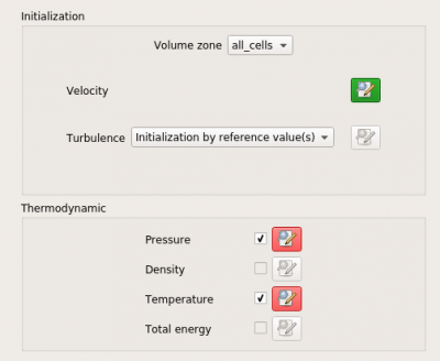

Hello again,
Is it possible that during the initialization the thermodynamic variables are not initialized correctly? I have attached a picture. Every time I set a value for pressure and temperature the icon turns green and in the context menu it shows the correct value. However, if I switch to another menu and then back, the icon is red again and die context menu says "Initialize the temperature in K. Tick the check box and ...". Does this cause my boundary errors? How or where can I add the missing part to my setup.xml file manually?
Christopher
Christopher
Re: PROBLEM IN THE BOUNDARY CONDITIONS USING COMPRESSABLE MODEL
I have learned to live with these buttons turning red each time the Initialization tab is left and then returned to.
Your case is running on Code Saturne v5.0.4.
I just downloaded and build the present v5 (v5.0.13) and with that your case does not run. I then recompiled a v5.0.4 to see if my build environment is bad. The newly built v5.0.4 also runs your case well (now with 6m/s inlet velocity). So the troubles seem to start between the two. v5.0.4 is not perfect as the case failed when I used mass flow for inlet boundary condition but it works with velocity as inlet boundary condition.
I you go that route you might get a copy of the code for v5.0.4 to build, if you ask the right place.
The button color is probably a minor bug. To see if information is lost, click on the button, to see if the formula is lost or kept from the previous edit.
It is quite strange the errors appear between revisions (normally bug-fixes) of a stable branch. I'll check this.
Could you provide the exact test case settings for that (I tested an earlier variant, but want to make sure i have the same XML and mesh). ?
