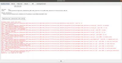

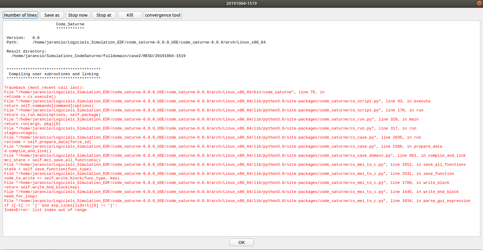

I tested CS by running FullDomaine Case2, and I got this error message (error.png attached)

The other error you have may be due to a bug, or a slightly more restrictive syntax in the MEI expression handling (now transformed to C code in the new MEG part for better performance). Could you post your XML file ? That is all I need to check that part.

The crash in your setup.xml file is due to some "fragility" in the way the expression is parsed so as to transform it to C code. More work on this is planned.
In the meantime, you can avoid the crash by using line breaks (I recommend indentation also) beween the if, then, else clauses.
For example, replacing:
if (0<=t<=3.8){ temperature=20 + 100*t; } else { temperature=400; }
with
if (0<=t<=3.8){
else {
 temperature=400;
avoids the crash:

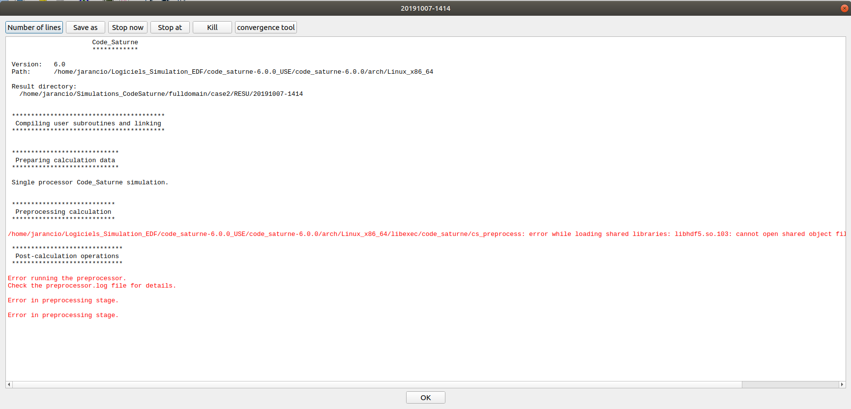

However, I got a new issue linked to HDF5 (picture attached)
I found a solution in this forum, but I don't really understand how to solve it
viewtopic.php?f=3&t=2500&p=13644&hilit= ... ory#p13644
Could you explain me pls ?

Is it possible that you installed the code from inside a Salome environment ("salome shell" or "salome context") and are running outside one ?
Do you still have the error when running unde "salome shell" or "salome context" ?
