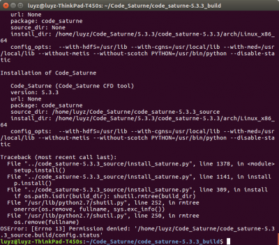

I have installed the packages (hdf, cgns, med), but encounter the problem of "permission denied" again when I re-run the "install-saturne.py".
Posts: 4290
Re: Installation problem with importing MED file
Yes, as I said in the previous posts, the sufo parts have to be run at each stage also.
This script is really not designed for sudo use.
