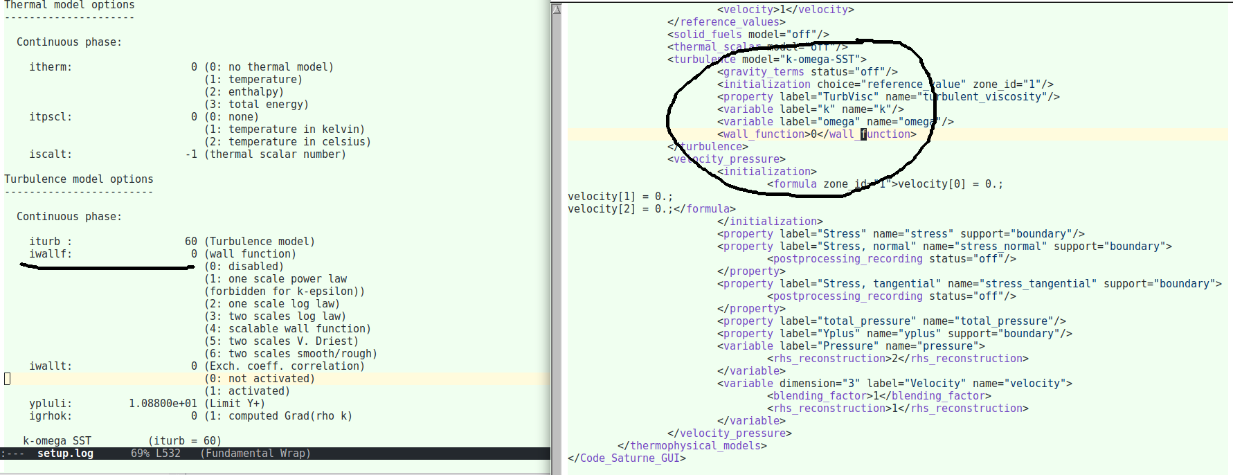

Did you solve this problem? I am facing the same issue with kw-SST ( I cannot select "no wall function" in the advanced options ). I am trying to figure out a way through the use of the subroutines...

What version are you using?
In version 5.0.8 when you open the "advanced options" in the turbulence model and select "No wall function" and save it, the value in the xml file is set to "0". But if you open it again the "2 scale model" appear like if the option has not been saved (May be a GUI issue).
Also you can check the value of iwallf in the setup file.
Luciano
Luciano

Hi Luciano,
thanks a lot for your answer!
I am using the version 5.0.8 and indeed iwallf was 0 in the setup.log.
FA

- Posts: 4290
Re: lift force calculation
The behavior Luciano explained (with the GUI resetting the wall function value when visiting it) was a bug. I just fixed it an will push the fix on the master branch (and possibly merge it on branches for 5.2.1, 5.1.6, and 5.0.10) by Monday.
For similar cases, do not hesitate to use the bug-tracker (not necessary for this one as I fixed it, but I may miss other details in some conversations I don't need to handle).
