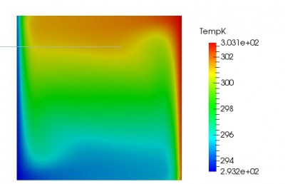

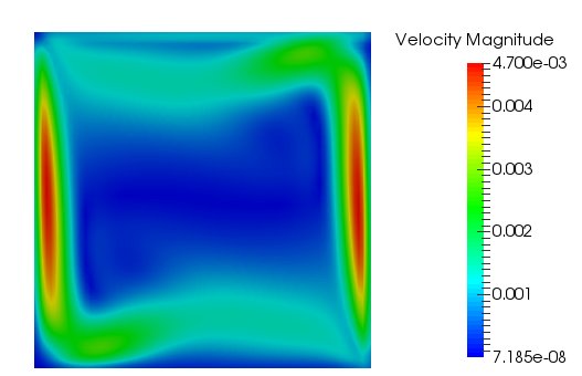

Hi,
Yes I followed step by step as in tutorial, only the temperature contour looks similar.

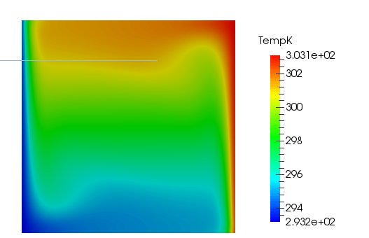

I didn't find anything strange in the listing. I attach a case file and a mesh which I get the solutions like in the tutorial.
Try to compare this case file with your case file in order to find the difference,
Luciano
