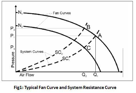

After that I have run a simple example ( A box with a fan inside) with your parameters. First of all I check your pressure curve and it has negative value of pressure, maybe there is a problem with the reference pressure. In general the curves are like this
I have run the example (no turbulence model) with your curve and with the used in the template of cs_user_parameters-fan.c without problem. I don't understand very well the definition of "axial_torque" but it is a relation between the axial and radial velocities.

Wth respect to the pressure curve, is a function of volumetric flow rate or velocity, because I dont understand what means with flow in th doxygen doc.

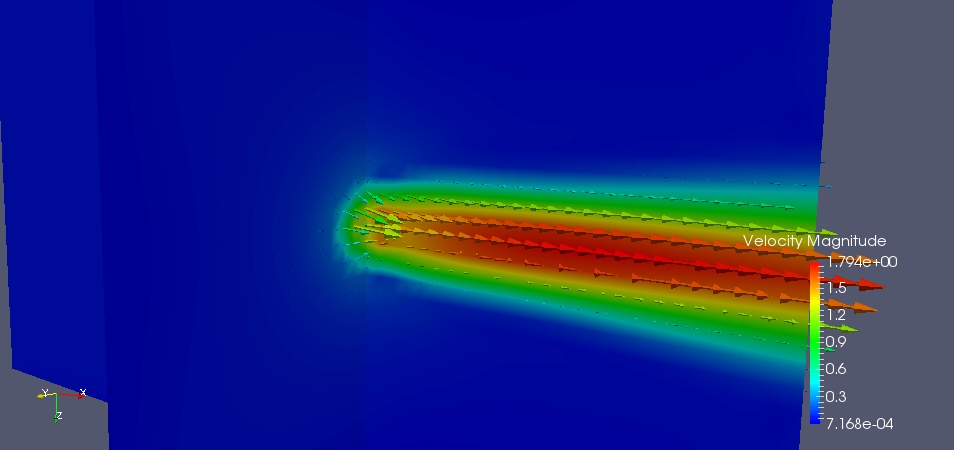

In my test case I have set inlet and outlet.
I attach the case file, the mesh and the fan function. If this case run without problem post your case in order to help you to debug the problem.
Luciano
