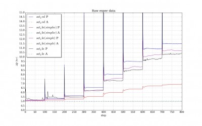

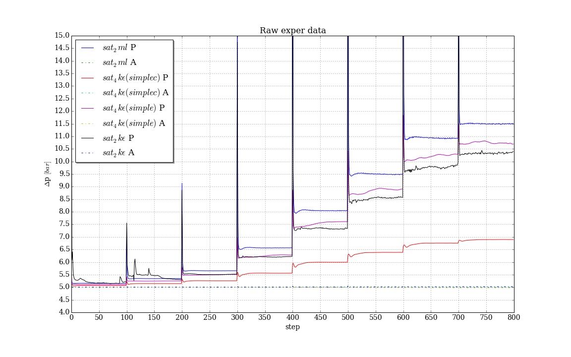

Yvan, I made a new experiment, changing the Velocity-Pressure algorithm, from SIMPLEC to SIMPLE and it looks like it is the main responsible for the differences. Even if I wouldn't say that the results converged to a steady state solution, they are much close to the ones obtained with sat2.
I still need a very long time (about 16 hours) to finish the simulation, which is longer than the time I needed with saturne 2.
Comparison of Saturne 2 and Saturne 4 results
Re: Comparison of Saturne 2 and Saturne 4 results

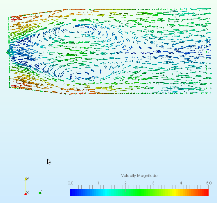

I performed some simple tests yesterday. It was my test case with irregular inlet velocity profile:
http://code-saturne.org/forum/viewtopic ... 8934#p8934
http://code-saturne.org/forum/download/ ... &mode=view
Pure aerodynamic, air, without head loss, isothermal, Steady. There was two setups:
1. SIMPLEC, defaults + reference time step 0.01 s.
2. SIMPLE, defaults.
Every case was allowed to calculate ~300 iterations. Then I compared pressure profiles in the slice just after inlet with ParaVis (ParaView) and found no sufficient difference. But there was no any large pressure difference (air) and flow pattern is different from valve. I plan to compose a dummy geometry more resembling the valve and repeat tests (if the reason will not be foubd here at that moment).

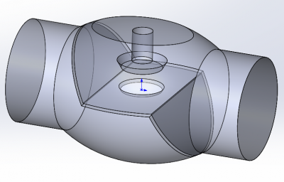

Hello. I worked with abstract valve geometry yesterday night. A saved this geometry in SolidWorks as STEP and played with STEP version, meters/millimeters and changing geometry. It didn't help. Looks like a bug in Salome geometry import (though two other previous geometries imported correctly). So I used IGES + create shell + create solid, but I only had a time to build the mesh, then I switched to other case (needed to calculate a pressure drop on nozzle for my work). Hope I will get the valve test results soon (SIMPLE vs SIMPLEC).

I created a topic on Salome forum, there is an attach with "abstract" geometry outline.
http://www.salome-platform.org/forum/forum_10/439129971
Geometry internals shown in attach to this message. Is this kind of geometry relevant? (I'm not working with valves, we use valves from another companies.)

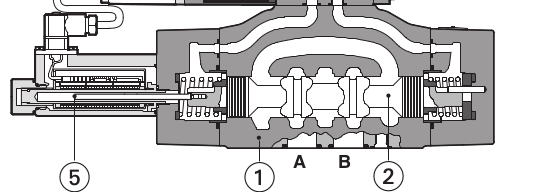

Most of the time I work with this kind of valves:
The component labeled with 2 is the spool that I place in different positions so that different connections and openings are made.

Thanks for geometry. I see that it's not a "classic" valve, looks more like a hydraulic switch, if I got it right... I understand that particular details are confidential so I will work with my "classic" abstract geometry. Hope that conclusion about SIMPLE/SIMPLEC sensitivity will be applicable also to your tasks.
