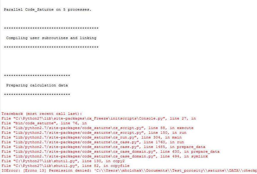

I'm trying to use the restart option on Code_Saturne 4.1 on windows. But when i start the calculation, the run is crashing during the preparing calculation data ( the pictures is attached). Have you ever seen the error IOError: [Errno 13] Permission denied: and do you know where it came from ?

This is due to a bug which was fixed, but we need to release an updated Windows version (the latest Windows build for 4.1 is 4.1.0, while version 4.1.3 has been released).
