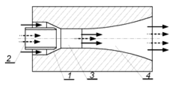

I found this post and it contains an issue similar to the one I'm currently facing: when I set a free inlet/outlet boundary condition the simulation diverges.
I've a sort of jet pump (see example picture), with a water inlet (1), a water outlet (4) and a suction (2).
If I set the suction (2) boundary condition as free inlet/outlet (because the flow can change direction based on the inlet/outlet pressure conditions) the simulation diverges, whereas if I set is as an outlet condition the simulation converges.
When i run the same simulation 1 year ago with a previous version of Code_Saturne there was no issue.
Is there any CS setting I can try to overcome this problem?
Thank you!
