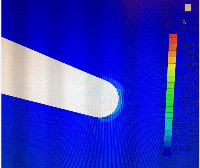

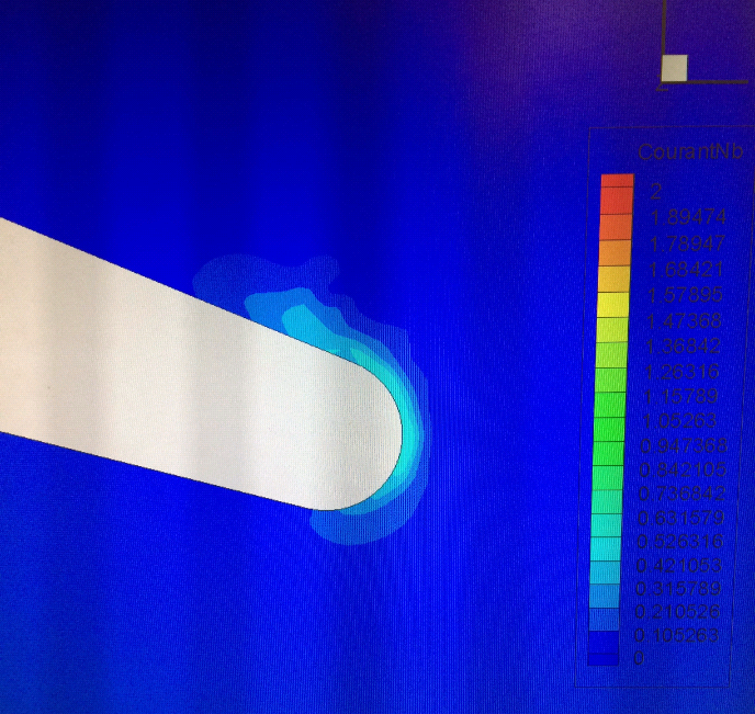

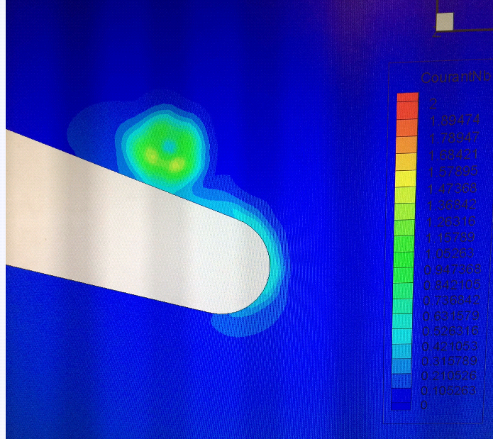

Hello, I managed to fix these two problems by adjusting the mesh zones. Now the code is running. Thank you very much.
However, the velocity and CFL number blow up after several hundred steps even if I set the time step as a very small value. I attached the CFL contours of 100, 200 and 300 time steps, after that the velocity diverged from the near trailing edge zone. I think this is probably a initial flow behavior of a circular trailing edge aerofoil, because I used same settings to a sharp trailing edge aerofoil and it runs fine.
I will appreciate if you can give me some suggestions on this problem.
Xiang
300 steps
300 steps
200 steps
200 steps
100 steps
100 steps

Re: Mesh imported ERROR: Mesh generated by pointwise
Choice of gradient recontruction algorithm or number of solver "sweeps" might help here.
