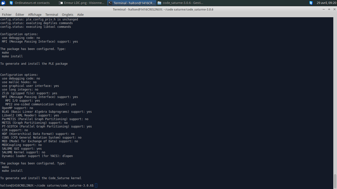

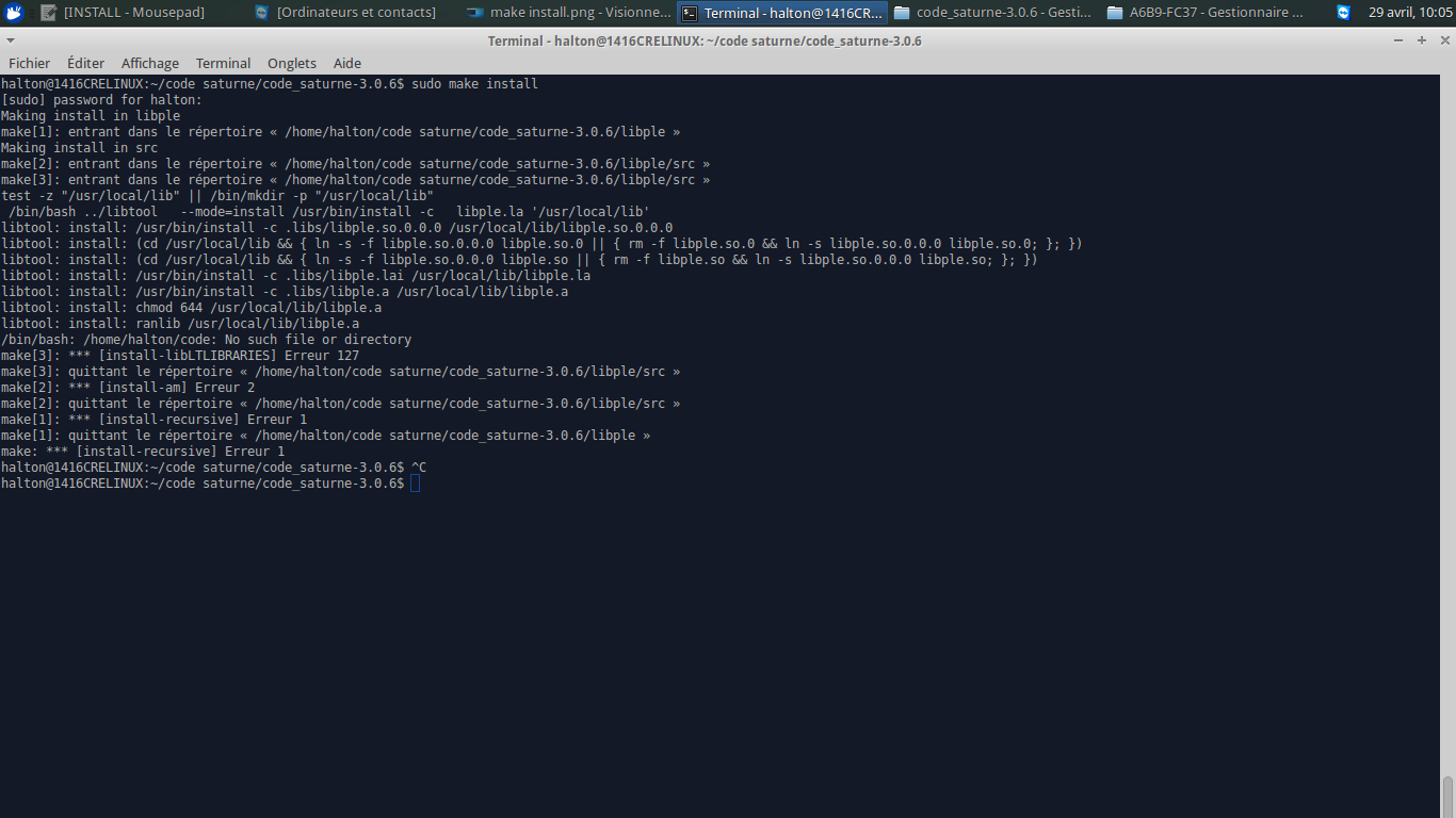

I have run in the shell, the commands : configure, make and make install,
I think, i don't have error after "configure" and "make" but I have some errors after "make install" :
- [Install recursive] Erreur 1
- [Install am] Erreur 2
- [install-libLTLIBRAIRIES] Erreur 127 (there is "just" a librairy to install ?)
- /bin/bash: xxx : No such file or directory
(as you can see in the attached files)
