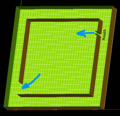

Without a picture of your mesh, it is hard to see what you mean by inlet and outlet inside the mesh (it probably depends on the level of detail of your mesh), but yes, thin walls allow you to handle this.
I recommend not modifying rtpa, as it is a computed quantity (that of the previous time step), and modifying it during a time step may lead to some inconsistencies in the numerical scheme. It may seem to work, but is not a precise way to do it.
There is no icodl/rcodcl for interior faces, so you cannot do this, but defining thin walls transforms interior faces to boundary faces (with minor issues for the volume post processing, which is not aware of the change), so you can use icodcl/rcodcl for thin wall faces.
So thin walls are probably the best solution in your case (again, not having seen our mesh).

Here is the mesh (without the upper symmetry wall):
Mesh (without upper symmetry wall)
the flow of cooler air enters the inner chamber through the mouth. The very same air flows back in through the outside duct.

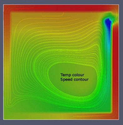

and here is the simulation:
This simulation is done with rtpa applied for velocity and temperature to the cell located inside the lips of the mouth, this in the cs_user_boundary_conditions.f90
Yvan Fournier wrote:Hello,
I think that my problem is a bit different since I want a closed air circuit. I believe that a boundary inlet cannot flow back in the very same inside air ...

I assume your closed air circuit has some simplifications (pump not detailed), or uses natural convection only (in which case you do not need to force anything, but must have a fine mesh and adapted turbulence models so as to get the most precise heat transfer you can).
By your image, you probably do not strictly need an inlet/outlet (or thin walls) : if you want to force a given velocity at a certain point, the best solution is to "measure" the flow through the area of interest (cells or faces), and use a use source term (with feedback based on the measure) to drive the flow you want. The examples in the user source terms user subroutines are a bit minimalist, but are hopefully enough. Otherwise, if you do not manage to find examples in this forum, I can send you one later.
To replace you thin walls by a mesh "opening" without editing the mesh, just use mesh joining with the same selection criteria you used for thin walls.
You can use separate (independent) source terms for velocity and temperature if you need both.

As for setting the temperature, I just saw that there is the example cs_user_extra_operations-force_temperature.f90 that uses rtp. So I believe that with some precaution the result should be meaningfull. I can stand some imprecision.
Source terms are too complicated for me.
With the rtp function, I can set the velocity and measure the real flow speed afterwards. This resulting speed is unstable but it seems that I can manage to set it with a good enough approximation (<+/-30%). I can stand an error of +/-50% for this velocity. If there's no other drawback, it's fine.

Yes, you may "not" (you do not need to use independent source terms; I just wanted to say it is possible if you need it).
It is true using source terms is more complex than forcing the values at the previous time step, but the advantage is not only that is is more elegant, but that you can "measure" the source term, which, in your case, amounts to the pressure difference the pump needs to provide.
Forcing the previous values do work most of the time (even if it is not my favorite solution), so if it works for you and is sufficient, good.
