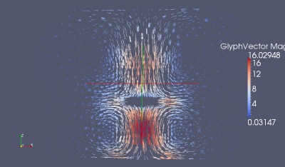

I'll wait for an answer, by the way now i'm having more sensed values using my configuration with k-epsilon one-scale wall. the 2-scale wall (default if you pick k-epsilon turbulent model) is used to diverge or to be unstable in my case :
stirrer (diameter 100 mm) in a tin (diameter 600 mm), fluid = air, 1470 RPM = 155.5 omega.
Now, after 100 step (steadystate) relax 0.7 you can see the result in the picture attached. They seems qualitatively correct. Now i'm rerunning until 500 step to see if the velocity values change to more converged values or not.
As a rule... during a general steady state case how can i choose the correct number of steps ? saturne by defaults says 10 but, as in this case, they aren't always enough.

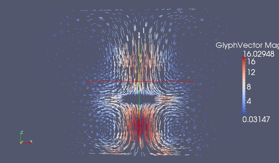

We do not currently have an automated convergence test (though I believe some colleagues are working on this), but 10 iterations seems a bit short.
To check convergence, I would either place a few probes and check their values history, or add a scalar tracer (passive scalar, initialized at 0, with an inlet value of 1) to check how long it takes to fill the domain, and multyiply thant number of time steps by 2.
Also, when using rotating coordinates, I do not believe a steady state solution is possible, except maybe with a "frozen rotor" model. Otherwise, using a fixed time step with an unsteady calculation (same means of checking convergence, but this may require more time steps, and you need to choose a basic time step so that CFL values are reasonable, that is do not significantly exceed 5 to 10).
