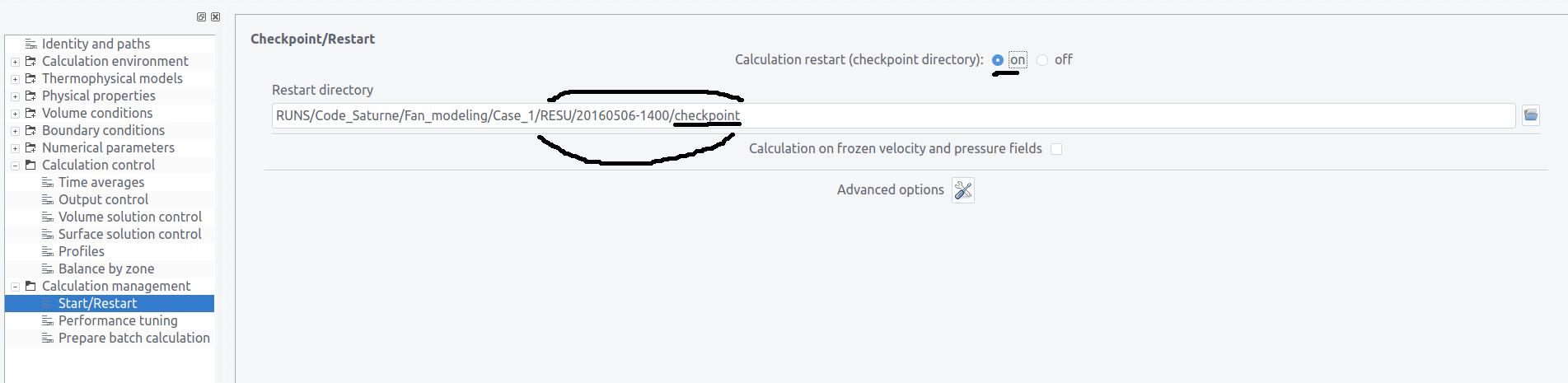

Code Saturne by default sets 4 restarts checkpoints during your simulation, you can change this frequency in "Advanced options" in the "Start/Restart" tab. If your simulation does not reach almost the first checkpoint (1/4 of the whole simulation) the directory "checkpoint" will not be created. but, if you have the directory "checkpoint", inside of it you will find two files "auxiliary and main" from where code saturne will take the information for restart. So, when you enable the restart mode you have to choose the "checkpoint" directory, not the files.

In order to restart a simulation do you have to go to Calculation management tab and switch on the "calculation restart". After that you have to select the Checkpoint directory of your previous run and set the new number of time steps to be run (Doxygen CS : "For the restart calculations, ntmabs takes into account the number of time steps of the previous calculations. For instance, after a first calculation of 3 time steps, a restart file of 2 time steps is realised by setting ntmabs = 3+2 = 5.").
The checkpoint directory only provides information of the last saved result. You can change the save frequency in the "advanced options" button.
