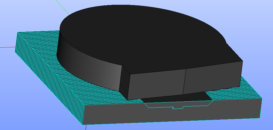

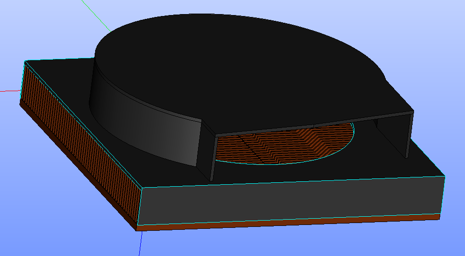

Attached 2 pictures of the heatsink solid domain (not included in the mesh file) and the fluid domain which is made from the 'air' inside the heatsink (this is the geometry used to create the mesh).
Regards, Jerome
