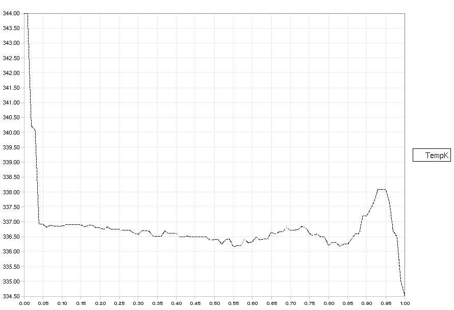

Moreover, what ever the simulation results I got up to 30000 time
steps that does not seems to be right. The velocity field and
temperature variations within the domain is attached here. I simulated
the same test case with other CFD software and got different results
which is compared with published results. I am trying to benchmark
Saturne, so we can use for our further studies.  I also plotted the
temperature variation at the mid height of the cavity along X axis that
is also does not look correct. In my simulation, I have a 2D square
cavity with two constant temperature vertical walls and two adiabatic
horizontal walls. Natural convection is happening inside the cavity
with radiation effects. It looks like somehow the domain is loosing
temperature.  The results are attached here though the simulation did
not reach steady state within this time steps. I am concern about the
velocity and temperature field predictions. There may something wrong
with the simulation. If this is the case, please let me know. The case
file and mesh file are also attached here.
Thanks and Regards
Mita
06090735.tar.gz
(637.53 KiB) Downloaded 385 times
Mita Sarkar
Re: Convergence Problem to Simulate Natural Convection (Buoyancy Driven Flow) Simulation
Post by Mita Sarkar »
In my previous post I could not attach the results plots. So, They are attached here. In my simulation, on left vertical boundary I specified constant temperature as 373 K and on right vertical side wall it is 323 K but the temperature profile at the mid height along X (horizontal) axis does not show that.
(9.56 KiB) Not downloaded yet

I did not get back anything about the results yet. If you have any comments about the results, please let me know. Whatever the solution it provided that is not realistic. Results shows somehow it is loosing energy. It is not maintaining constant temperature on both vertical walls during the simulation though I specified constant temperature value.
