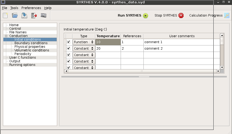

By the way, it's really simpler to impose a block initial condition with the new graphical interface of SYRTHES 4.0.x.
If you are not obliged to use the 3.4v, you should download the 4.0v (be careful you must remove "middle nodes" in the meshes for Syrthes4).
