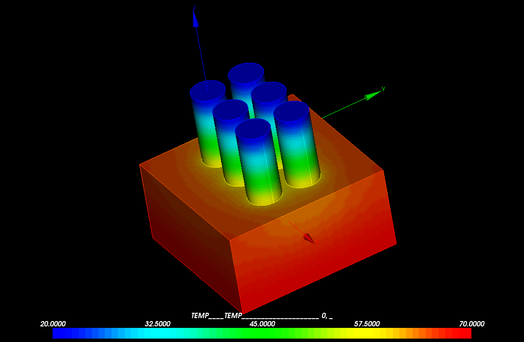

Is there a REASONABLY uncomplicated way of chaining a thermal analysis from Aster
with Saturne?
I'd like to simulate water or air flowing over a heat sink and experiment with different mass flows etc.
So far I've successfully applied uniform thermal flux (or temperature) to the walls of the domain, and the calculation has reached a steady state.
In Aster I have calculated a temperature field and have a nice gradient.
Now the questions is: is it possible to use the results from Aster (the field from the surface group that the original part and the flow domain shares) as input to Saturne?
When you're explaining it, pretend you're explaining it to someone who doesn't have a Ph.d in fluid dynamics (in fact, don't pretend) :)
I've attached two images to better explain what I mean.

Hi Claus,
I would say that there is no straightforward way to transfer data from Code_Aster to Code_Saturne... Code_Aster generally outputs data in MED format and we cannot easily read MED files for boundary conditions definition. Of course, you could try to output information in text files from Code_Aster and then code the reading in the usclim subroutine of Code_Saturne... but I don't know if it is easy to do that in Code_Aster!
An interesting solution(and easier) would be to use SYRTHES for the thermal calculation in the solid, and then have coupled simulations of conjugate heat transfer (better than just chaining for transient flows by the way). Afterwards, you could even transfer the thermal field in the solid to Code_Aster and compute stresses.

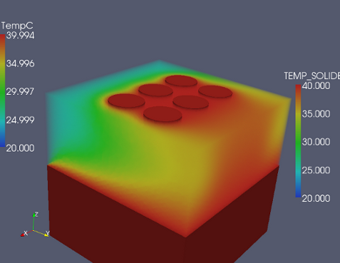

In return for an answer, a pretty picture of 25C air flowing over 40C pins - BCs for bottom of pins part: Dirichlet 40C, thermal flux of 0.002W/m^2
For some (unknown to me) reason, the calculation becomes unstable about 60% in when exchanging air with water - I will figure that one out soon.
Claus

Note on the attachment - air exchanged for water, same BCs as before. Only fluid >25C (inlet temp) is shown by the volume filter.
