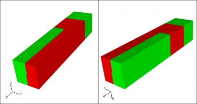

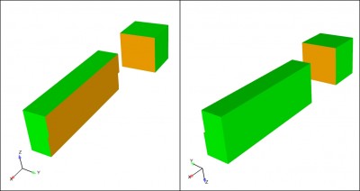

When I use cs_preprocess to view the mesh with Ensight I see that there are some isolated faces (the red one on pic01), that's not good and faces with no attributes (yellow faces on pic02).
As I don't know gmsh I'm not sure that it will help but perhaps you have some problems merging the different parts of your mesh. Did you define all the boundary faces?
