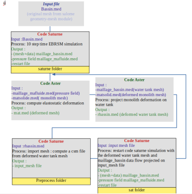

Concerning restart strategy i have followed your advice and read some post to make it work. I have drawn a graph which details data transfert and folders are stocked here
https://unicloud.unicaen.fr/index.php/s ... Ped296Eyg
But i have two interrogations
first one : To start i launch a first sudy (folder saturne) and i determine the water tank mesh deformed. Then i transform this med file in a csm one (preprocess folder). And at last i restart the initial saturne study (sat folder). So does it right to create a new saturne study (sat folder) and locate the checkpoint in folder saturne/EBRSM/RESU/20240110-1556/checkpoint. Indeed i would like that saturne compute the deformed tank mesh associated with the first data flow

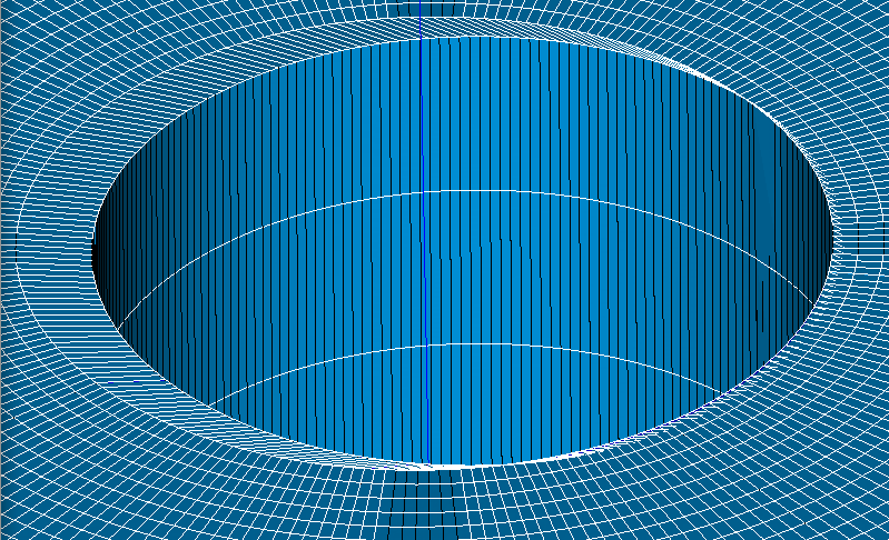

Concerning geometry, the deformed mesh has the same number of nodes and position than the original one except nodes which belong to the cylinder boundary hole. These nodes have been translated as we can see on the picture To begin i will try your first strategy. Owing to the fact that the deformed mesh has to be computed by Code aster do i need to launch three successive Code saturne calculation as described in (graph1). If I want to repeat this process should i adopt the following strategy (cf graph2) ?

- fsi.pdf
- (43.62 KiB) Downloaded 2345 times

Graph2 seems better adapted to an iterative solution, assuming the flow has a significant influence on the water tank.
What i not clear to me is the type of flow you are trying to compute. Most FSI studies done with code_saturne involve interaction with a complex flow, such as flow induced vibration of tube bundles. For a tank with sloshing, you would need ALE of VOF for the free surface in addition to the FSI aspects along the reservoir/tank walls. For an application such as sloshing with a fixed surface, using a simpler model than code_saturne would probably do.

The aim of this work is to study interraction between waves and monolith. But we're working step by step. So, at first, i try to validate the process of sharing data between CS and CA with a simple situation in which water is flowing with a velocity of 0.16 m.s-1 at the inlet. When it will be done we'll use an ale model with free surface as shown https://sites.google.com/view/wavecfd/h ... aturne-ale.

The process seems efficient
