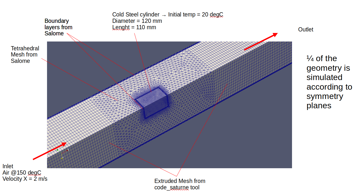

The case:
To resume, I want to simulation the heating time of a steel cylinder in air forced convection ambiance (at different velocities), the natural convection is neglected.
I have already done simulations with CHT OpenFoam solver and experimental measurements. (See my first post with the results)
I want to use CS for comparison and use it in the future because of the GUI and all the user friendly tools you have developed with CS.
The strategy:
First I calculate the stationary air stream with air parameters fixed at 150 degC (rho = constant, conductivity = constant, Cp = constant). The initial temperature of the steel cylinder is taken at 150 degC to improve the convergence speed.
Secondly I use as checkpoint the frozen flow and measure the transient heating time of the steel part, initial temperature of the steel cylinder is 20 degC.
The simulation parameters:
Please see the Mesh + velocity results to have a better understanding of my case.
