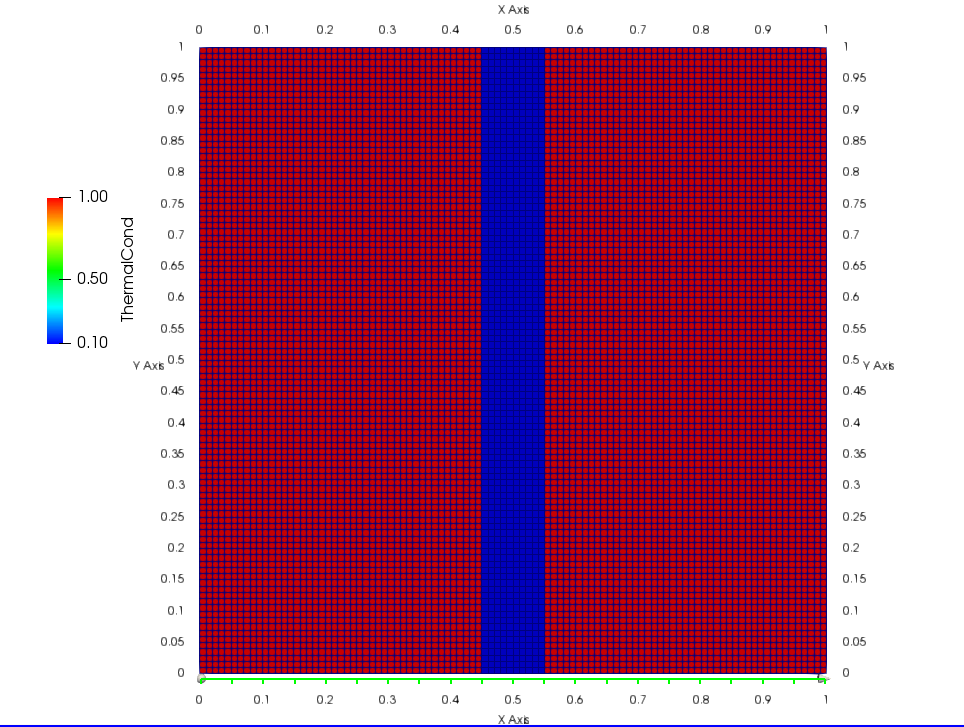

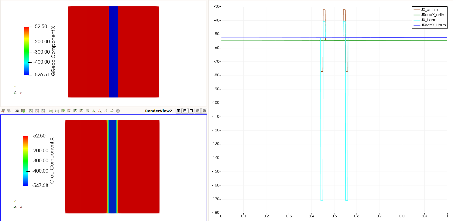

I am facing a problem when computing the gradient of a scalar field with a variable physical property (conductivity) in the domain. Using the cs_field_gradient_scalar() I can compute the correct gradient in the domain, but in the cells in the interface between different properties, where a discontinuity in the gradient exists, I get an erroneous (an average) value. Then, when I use this gradient and the cell value of the physical propertie to compute, e.j , which should be constant in this very simple test case, but I get an overestimate value and in the next cell an underestimate value (Fig 2).
I am using harmonic face diffusion to compute the diffusive fluxes.

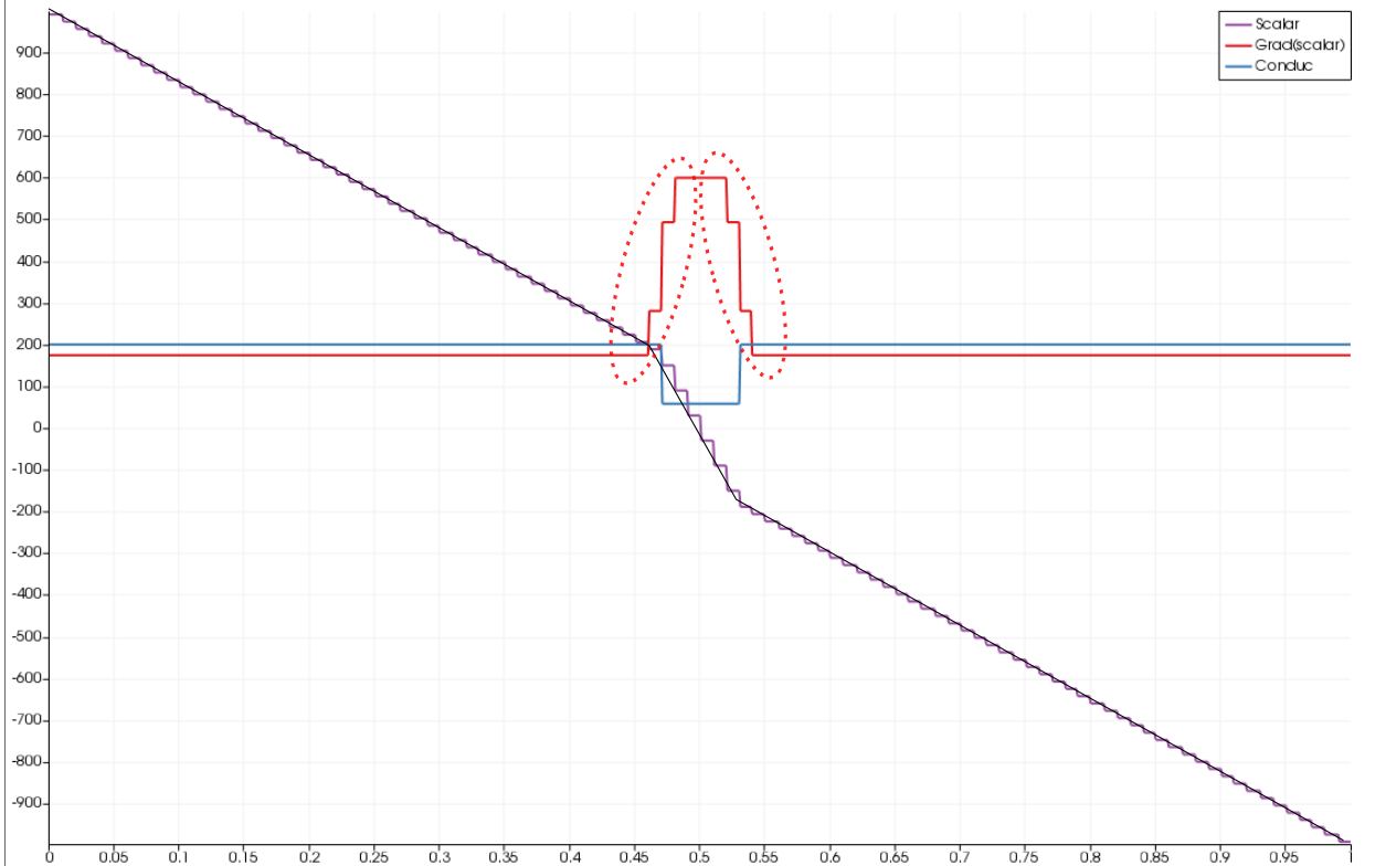

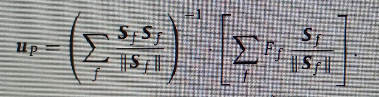

Yes, both lead to the same issue. In discussions with colleagues at the institute, two options emerged...one was to obtain the potential face value using the fluxes and then compute the gradients based on this face value and the local conductivity. This option works well in cartesian grids but I have my doubts in more general meshes. Another option is to compute the cell gradient using eq. 3.4 of this paper (https://www.sciencedirect.com/science/a ... 9118301931. I test this option and also works well.
Eq. 3.4
Result - orange line.

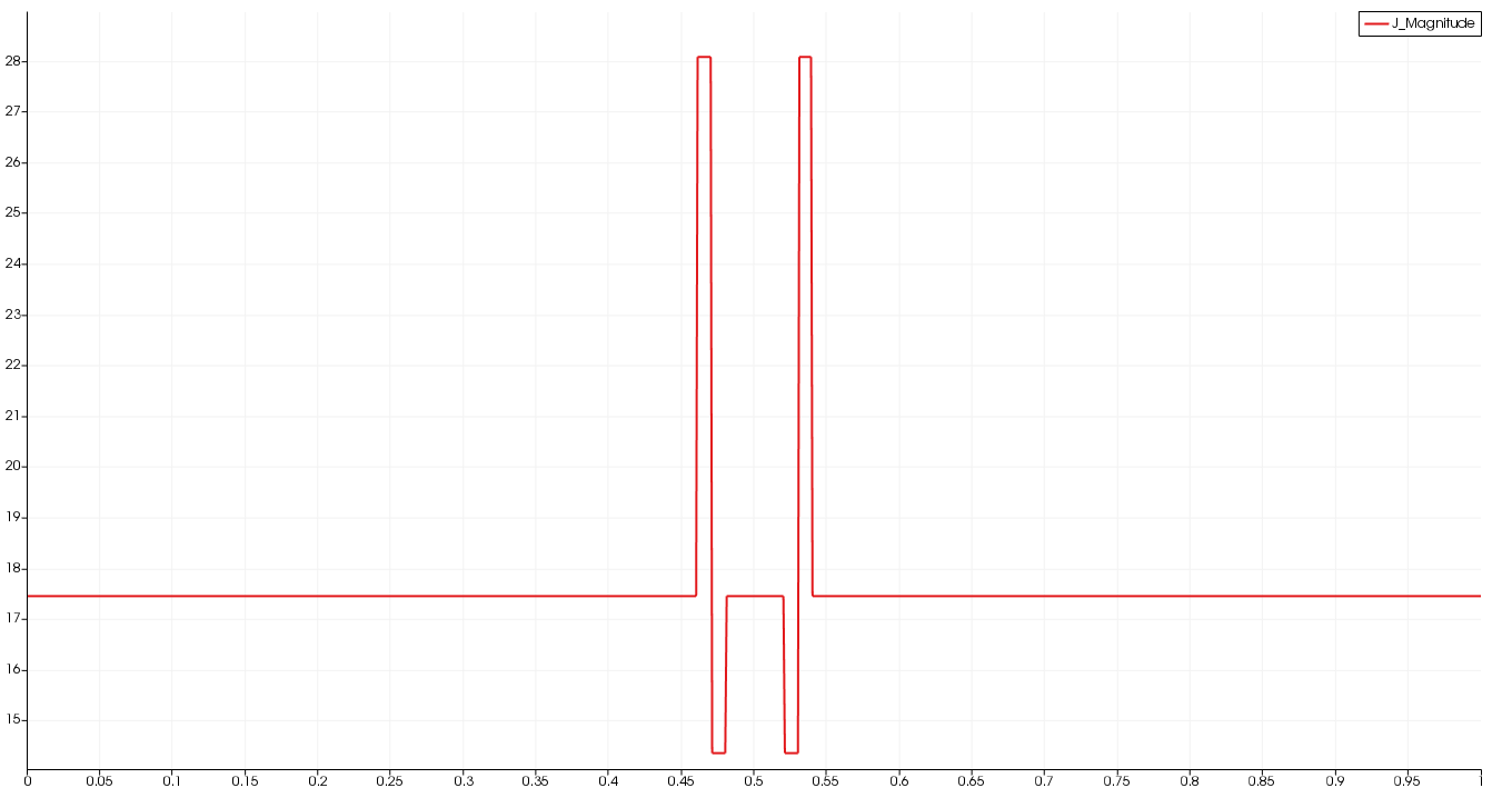

Attached it is a very simple case (1D) with the comparison of the cell gradient reconstruction for the temperature. The J fields are the thermal fluxes and the Grad fields are the gradients.
Additionally, in this case, with different thermal conductivities in the domain, the thermal flux is not correctly computed (compared with the analytical) with the arithmetic face viscosity field interpolation and should be used the harmonic interpolation as mentioned in the theory guide.
Let me know if it is ok, or if I am doing some mistake.
