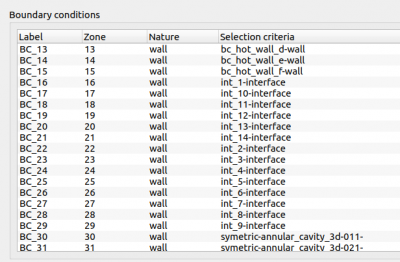

During the mesh preprocessing stage, in the face joining option declared all the selected interface. But unfortunately during loading of the preprocessor log file, the same is appeared as wall. Please find the attached screen shots and the log files.

Joining is actually applied during the preprocessing stage of the main solver, so it is normal that they apper this way in the preprocessor.log. You should check how this is transformed in the run_solver.log file (and you can even postprocess/visualize the joining to make sure everything is ok).
