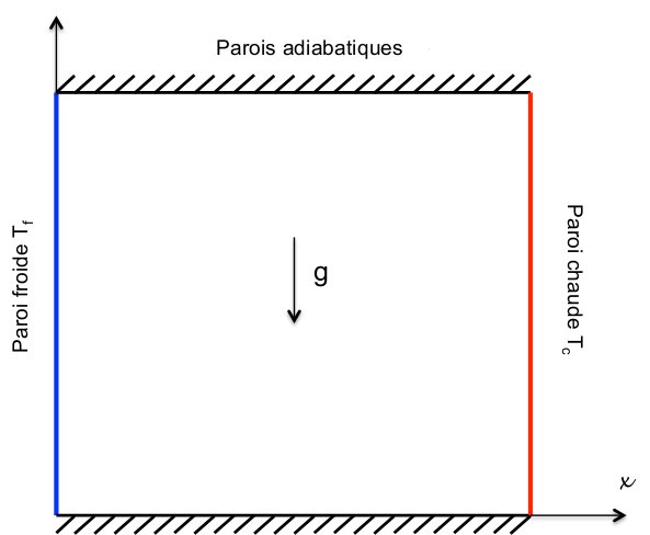

Now I'am working on the natural convection (Boussinesq approximation) with a high Ra number 1.5x10⁹ in a square geometry(1mx1m).The mesh is 100x100. With this mesh for a small Ra=5x10⁶ and laminar flow, the result is good. When I increase the Ra number with 1.5x10⁹, the flow is turbulent, so I use the LES model(Smagorinsky), some errors happens as shown in the file attachement. I think it is not the problem of the mesh because I've tried with a mesh 150x150. If I forget to add subroutine when I use the model LES? Besides,Smagorinsky model propose the subgrid viscosity for the Navier-stokes, if I need to add the model of subgrid thermal diffusivity for energy equation?
