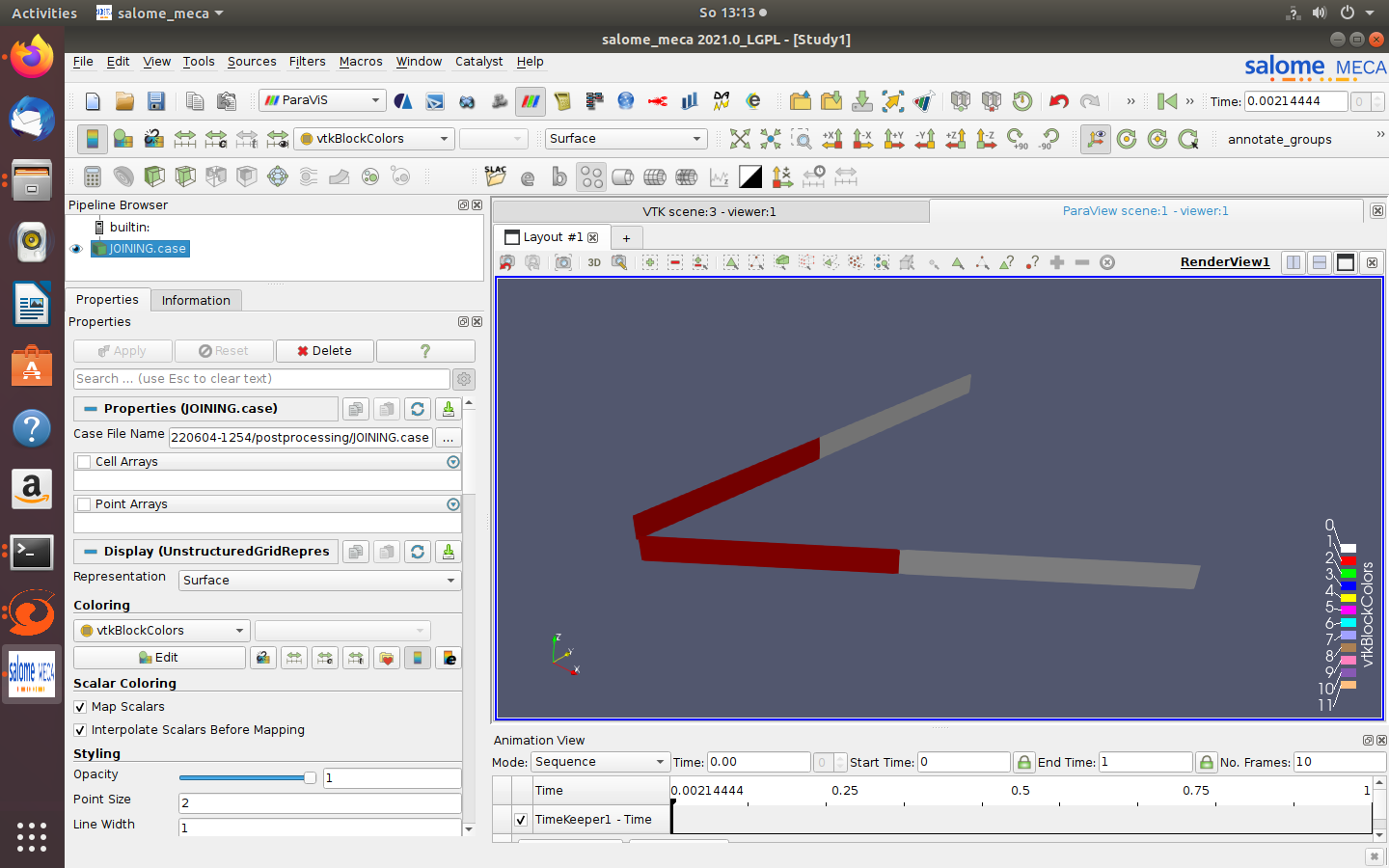

I try to simulate the turbine via turbomachinery modul with combination of rotation periodicity. I found some old topic on forum about that problem. From this reason I created the simple case to check. If I set the 2 sets of rotation boundary without settings of turbomachinery then the process run without issue. Then if I set the turbomachinery in section of calculation features then I get the message. If I check the joining faces it seems to be OK.

My simulation was with sittings of frozen rotor.
I tried to simulate this case again and I also joined the rotors first. But I had the same error message as before.
Is there some possibilities to check if it is possible to simulate the turbomachinery with frozen rotor + rotation periodicity?
