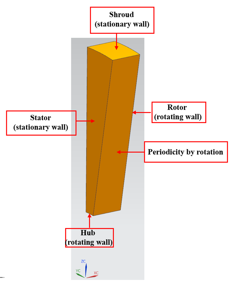

I am running v7.1.0-patch for a basic test case of a closed rotor-stator cavity. The schematic of my model is shown below. But I found the result depends on whether I run in a stationary or a rotating frame, which is not what we expected. In Sta. frame, the results are always correct; in Rot. frame, it is wrong.
When I run in a stationary frame, I just set rotating speed as boundary conditions to the rotating walls. When I run in a rotating frame, I set the Coriolis source term (rotation vector), i.e. icorio=1, then set reverse rotating speed as boundary conditions to the stationary walls.

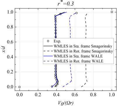

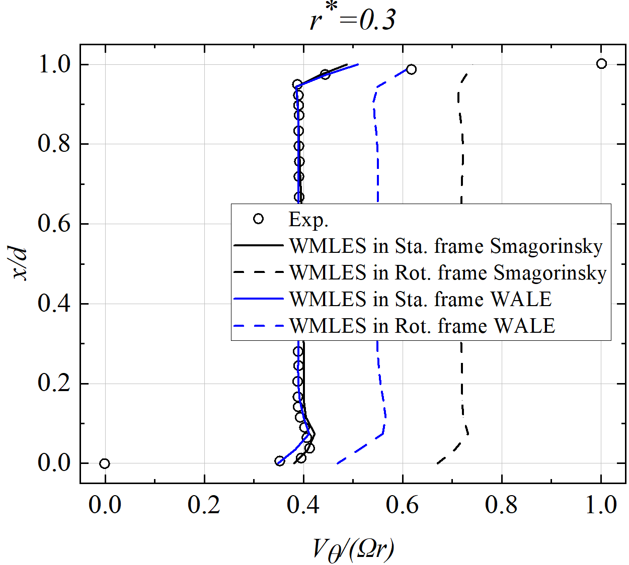

From the figures attached below, we can see: for RANS, the k-ω SST model is frame-dependent, but the S-A model is frame-independent. So I'm using S-A model for RANS now.
For wall-modelled LES, I tried Smagorinsky and WALE, found both of the two SGS models are very frame-dependent. I need to run in a rotating frame, which is better for my rotating flows. But the current results of LES in rotating frame are all wrong.

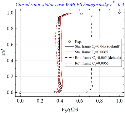

For LES, I'm also confused. As shown in the figure above, in a rotating frame, different SGS models give very different results. As shown in the figure below, I also tried to change the Smagorinsky constant, in a rotating frame, different Cs values also give very different results. But it shouldn't be like this.
In a stationary frame, changing SGS model and Smagorinsky constant both have little effect on the result, which is good as we expected.
I suppose something is wrong in the equations when running in a rotating frame but I haven't found the error. Thank you for checking with your colleague (I suppose is Benoît). Very much look forward to his ideas.

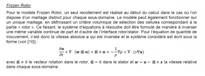

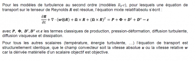

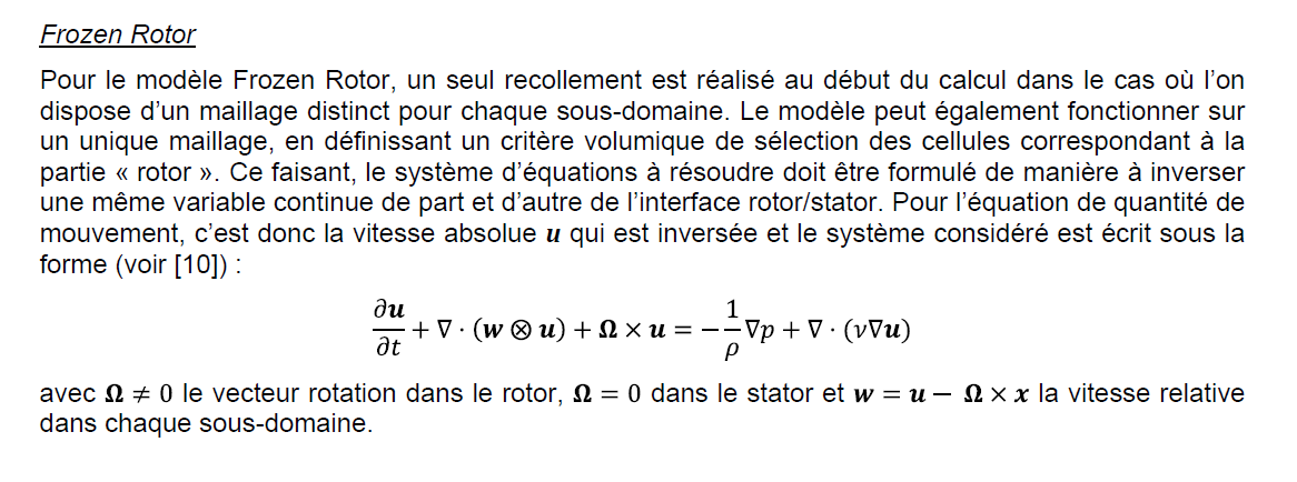

So, have you consider to use the frozen rotor turbomachinery model instead of icorio ? For the rotating part, it is a somewhat hybrid formulation where all the terms are related to the absolute velocity except the convective flux which is relative (see also the attached short description). In principle, this formulation is better maintained.
You could indicate that you have a rotor with "all[]" for the rotor cells selection criteria and give a "0.0" sliding velocity at stationnary walls. You can find additionnal information here :
