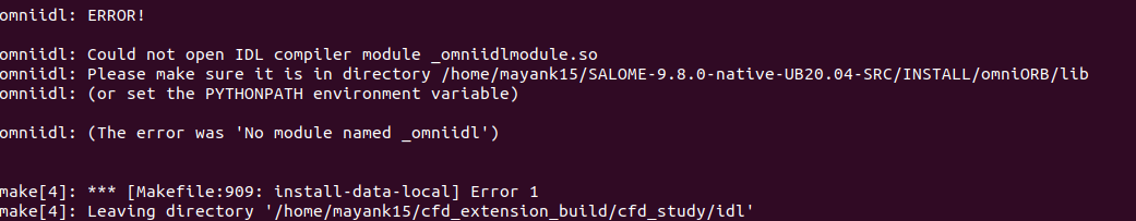

Hi
I somehow could configure and build the extension into a build directory. However when I invoke make Install I get the following error:
omniidl: ERROR!
omniidl: Could not open IDL compiler module _omniidlmodule.so
omniidl: Please make sure it is in directory /home/mayank15/SALOME-9.8.0-native-UB20.04-SRC/INSTALL/omniORB/lib
omniidl: (or set the PYTHONPATH environment variable)
omniidl: (The error was 'No module named _omniidl')
omniidl: ERROR!
- Posts: 4288
Re: Troubles with "Salome-CFD extension"
Yes, Omniidl is statistically the library causing us the most issues with the salome_cfd extensions...
Is the .so file mentionned in the appropriate directory, as per the error message ? In that case, adding a PYTHONPATH as indicated or through LD_LIBRARY_PATH might work. Otherwise, we nned to find that file in the salom install (and understand why the path is not correct). But as the path mentions your user account and not some build directory, I guess the installer updated the paths correctly, and the issue is probably later.
Also, please copy-paster error messages as text rather than as images: it make it much easier to copy/past file names and paths and suggest appropriate parameters for your case.
Dear Yavan,
Thank you so much for the reply. I no longer have this error coming. I could remove the error after re-installing SALOME again.
