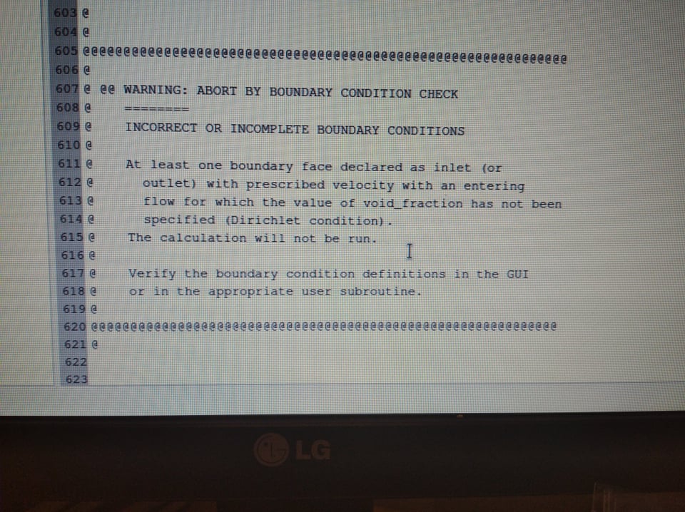

I tried to find solution but without success. Every time I get the warning that you can see in attachment.

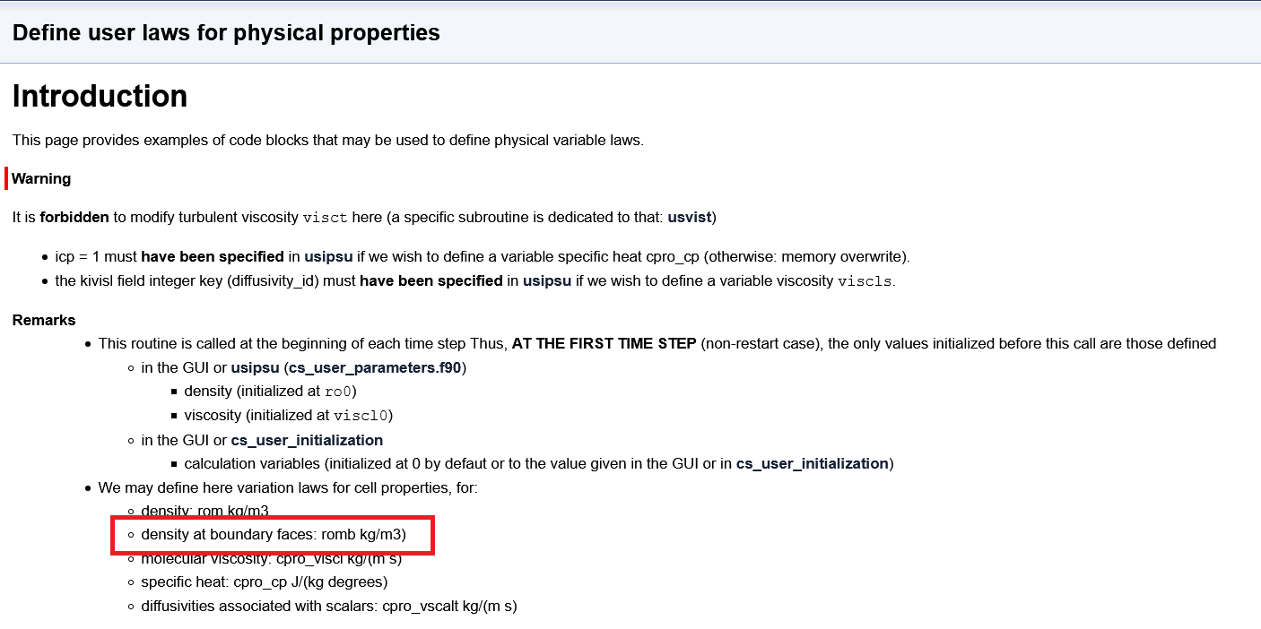

In documentation of Code Saturne I found that is possible to set the density on boundary faces but I don't know if it is what I need and it don't works me.

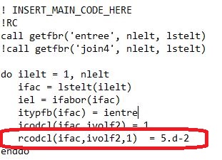

I found the solution for setting the input with combination of VOF. The solution is in attachment but I would like to ask what exactly mean the expression rcodcl(ifac,ivolf2,1)=5.d-2.
I didnt find the description to this expression in documentation. I try to set various value of this coeficietn and it seems to be the proportion of medium 2 in medium 1 at the input but I am not sure.

To define boundary conditions, one can use in cs_user_boundary_conditions.f90 the expressions icodcl(ifac,ivar) combined with rcodcl(ifac,ivar,i). icodcl sets the face boundary condition code (1 Dirichlet, 3 Neumann, etc.) for a face ifac and for a variable ivar, and rcodcl sets the boundary condition value : rcodcl(ifac,ivar,1) value of the dirichlet, rcodcl(2) value of the exterior exchange coefficient (infinite if no exchange), rcodcl(3) value of the flux density (negative if gain) in w/m2 or roughness in m if icodcl=6.
rcodcl(ifac,ivolf2,1)=5.d-2 therefore means that you apply the value of 0.05 to the volume fraction field akpha reference by ivolf2 for the Dirichlet value (due to the 1 argument) at face ifac. If the medium is full of Fluid 0 then alpha = 0, if the medium is full of fLuid 1 then alpha = 1.
