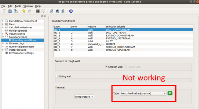

Please I want to report a bug I faced but fixed when setting temperature boundary conditions in GUI.
My test case is about heat transfer in a rotating cavity. I was trying to specify a temperature profile T=f(r) on a wall. When I set it in the GUI "Boundary conditions-Thermal-temperature-Type-Prescribed value (user law)", I cannot get correct results (Tplus, Input_thermal_flux, Dimensionless_heat_flux) compare to experimental data.
But when I specify this temperature profile in the user subroutine "cs_user_boundary_conditions.f90", the heat transfer values turned to be reasonable.
Note that when I use the Prescribed value (instead of the user law) to set a constant temperature value, the results are ok. So I suppose this is a bug when using the "GUI user law" to set temperature boundary conditions, as shown in the figure attached.

Hi Yvan,
Thanks for your reply. Please find the .XML file and the subroutine attached here.
Two walls named "DISC_UPSTREAM" and "DISC_DOWNSTREAM" are specified with a temperature formula. When using the .XML file, although we can get correct temperature values as specified on these two walls, the "Tplus, Input_thermal_flux, Dimensionless_heat_flux" values are not correct. But when using the subroutine, the results turned to be correct.
Thanks for the help to fix the bug!
